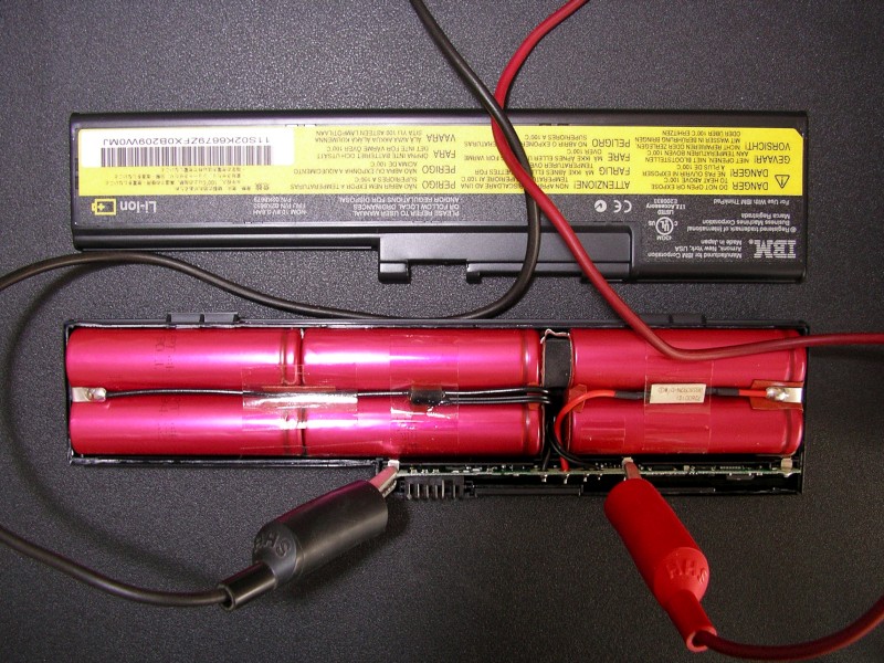

To recover some capacity, I had to charge/discharge the weakest cell to make its voltage closer to other cells. I did not get much capacity back, but at least now it can be charged to 100%. Hopefully I'll get more capacity back after more cycles of use (this battery has not been used for a long time, only 76 counts). After I opened the case, I realized that I did not have to open the entire package - I only need to cut some holes with a Dremel:
What's showing in the picture is charging the middle cells. To charge the left or right cells, use the tips of the big black and red wires soldered on the PCB. As you can see, these terminals can all be easily accessed if you drill holes above them.
In conclusion about reconditioning: disable standby and hibernation timers but do set the alarm action to be "standby" at 3%. Keep the machine running on battery (AC unplugged) until it goes to standby mode, then plug in AC to charge it until the battery LED is solid green.
