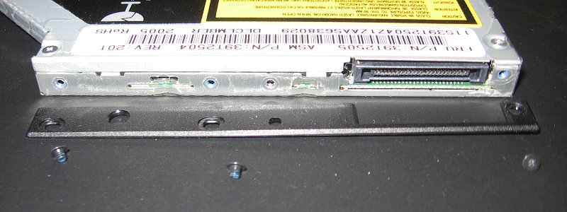

Here's the good news: that SATA HD adapter works inside my X4 dock:
http://www.kawakami-ca.com/ultrabay_sli ... d_adapter/
It also works inside a T41 without any changes or alterations needed on the adapter (despite what ThinkWiki has said). Maybe this knockoff has already taken care of that problem? All I know is that I swapped out the DVD drive from my T41 and pushed this SATA HD adapter in and it works.
Re: PATA or SATA Ultrabay HD adapter for X41 T
That's interesting. I have a Lenovo SATA ultra slimbay hd tray in my T61 and it physically will not fit in the X4 Ultrabase that I use with my X40. I do swap a DVD burner between the T61 and the X4. I remember someone saying the sata hd tray had a tab that you could cut off to get it into the X4 but I figured the tab must be there for a reason. I had figured I'd just get a PATA tray for the X4 if I wanted to add a second HD to my X40.
- Posts: 10053
Based on that observation, I have updated my site with some photos and measurements of the SATA adapter as compared to an IBM PATA adapter. From the looks of the label and the construction of the SATA adapter I bought, it appears to be a knockoff; a fairly good one from what I can tell. I don't have a genuine Lenovo/IBM SATA adapter so I can't say what the tab might be for.
