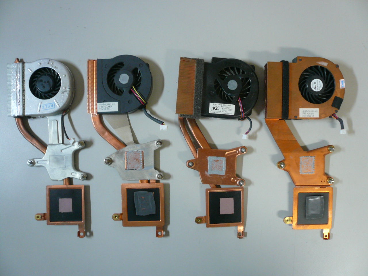

the defect of the shaft has been corrected in some fans built later, including those of the T61P and in a model of fan suitable for x60-x61 ULV; the shaft is very thin and has worked to make less contact as possible with the seat where he turns, and is extremely quiet. fru 42X3804
clearly if I had used this heatsink on my x61 I will have overheating problems; the heat sink element is half that of the original 42X3805

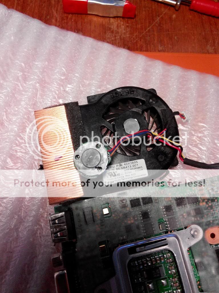

the second part (42X3805) is a bit 'more' difficult, we try not to break anything with the help of a knife and very gently, the original engine is not glued but held to three points in melted plastic, enough 'to cut with the tip of the cutter and the work will be 'done.
http://i943.photobucket.com/albums/ad28 ... g~original
at this point will be enough 'to paste the complete engine on the chassis of the 42X3805 with attack or similar glue, the hole is the same size of the engine.
