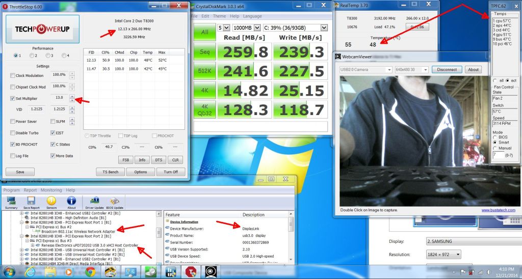

So far it works fine, identifies as a generic USB2 camera.
Here's a screenshot where I've tried to demonstrate all the current hacks in one. There are a few odd things, like the CPU multiplier not reporting equally between different apps, and the CPU not actually getting to 13x (only 12.5) as far as I can tell. Duh, enabled Dual IDA. I've overvolted using 18K 16K resistor, this still isn't quite stable at 3.46Ghz. Interesting things are pointed out with the red arrows. So far so good...
https://dl.dropboxusercontent.com/s/5yg ... oard01.jpg

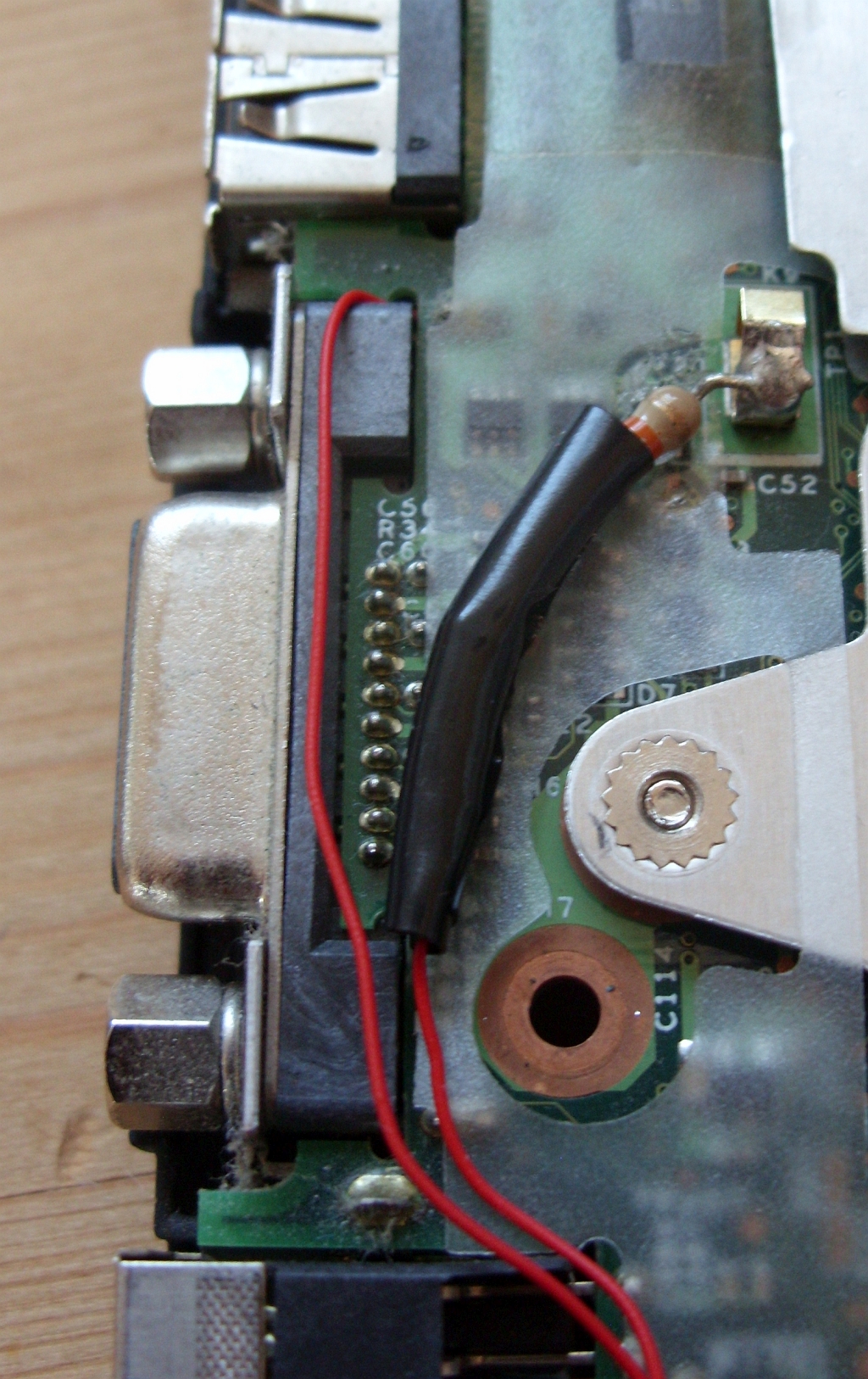

If you need more space for the mods, I found a way to get rid of that useless second fan. Without FAN ERROR.
Pic warning! http://thinkpad-forum.de/threads/182970 ... lermeldung
Bridges in the circuit to the main fan didnt do it. But removing the components between the socket and chip U26b, and switching the U99 EEPROM with one from a board that did not have the second fan worked.
More space for putting in stuff that actually works.

Things (kind of) work!
Here's a pic of the new wiring without switches, which works:
http://drive.google.com/uc?export=view& ... U15Y3psU1k
Here's one of the drives both being visible (booting from regular HDD, the two other drives are partitions on the SSD):
http://drive.google.com/uc?export=view& ... klrdllyOFU
Here's one of the switch board I made. Traces are length matched, but half of it doesn't work. I'm not sure why yet, but any time I plug in the SSD, nothing else works.
http://drive.google.com/uc?export=view& ... m81ZVVNSkU
...hope the links work.
Updates to come as I figure out why it doesn't work, but the project seems like it's getting close to done!
R
R
Re: X61 - Proposed hacks under $500: Dual HDD/SSD kind of works.
Wow! Little shrink tubing. Four little white plugs. What chips are they attached to and what do they do.
@E350:
No chips, just switching the SATA data lines between the two ports. The SSD seems sensitive to trace length or noise though, it doesn't like the board.
@x61s-1701:
Yes, you need a whitelisted BIOS, look for Middleton's one. You won't be able to boot FROM a HDD connected to that card though.
