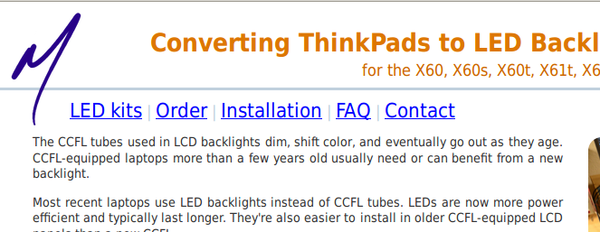

First batch of TLD3 came out perfect! Fittings work nicely on my various test machines. The second rev LED strip is also good... I was worried the staggered groups would cast a weird unnevenness on SXGA, but if anything, it appears to have reduced the tiny amount of remaining shadowing.
I've also got a first cut of a website update up at http://people.xiph.org/xiphmont/thinkpa ... ight.shtml. Just a few more blocks of text, a few pics, and the design files for the boards left to upload. Upt-to-date installation instructions are there.
I think we're out of Beta!

The x61 TDL1 board and 335mA LED backlight are working great in an x60s LTN121XJ-L07 with coreboot (version 4).
xiphmont wrote:I've also got a first cut of a website update up at http://people.xiph.org/xiphmont/thinkpa ... ight.shtml. Just a few more blocks of text, a few pics, and the design files for the boards left to upload. Upt-to-date installation instructions are there.
Here's my edit:
http://www.jesseo.com/kites/asfd-98.png
About the removed 'about' link. It's supplemental information - place it in the text of other pages where it'll be in context / useful.
Btw, I've ordered an XGA HT121X01-101. Which driver and which backlight does it need?
Well, the site is not just about my kits, or selling my kits, or even telling a linear 'buy a kit and install it' story. It's sort of a temple dedicated to the craft of modding.
That said, folks who are on the 'buy it/install it' track may not be interested in all the extra info. Ordering and installation has to remain somewhat streamlined to avoid losing.overwhelming people.
So yeah, it all has a dual personality. Tl;dr, the 'About' page/link is staying :-)

It's just a TN screen?! Darn, I read BOE Hydis XGA and assumed that was not TN. contrast and color saturation would be better than my LTN121XJ-L07.
Ok. Consider renaming the link text to something more descript and which tells the user what's, if this were price is right, "behind door number two". One try is 'Overview'. Btw, about navigation placement - look up "heat maps" and you'll see why I repositioned the navigation in my mock-up.
Re: X6X-series LED backlight conversion kit howtos
Posted: Thu May 05, 2016 10:10 am
by xiphmont
jaspen-meyer wrote:It's just a TN screen?! Darn, I read BOE Hydis XGA and assumed that was not TN. contrast and color saturation would be better than my LTN121XJ-L07.
I've never had a new one to measure what it's supposed to be like with the CCFL. With LEDs, the BOE screen is warmer, but contrast measured about the same with a 10-degree FOV, 186:1 vs 166:1. My impression was they were comparable-- very narrow vertical viewing angles on both, but both exceedingly bright compared to AFFS.
jaspen-meyer wrote: Ok. Consider renaming the link text to something more descript and which tells the user what's, if this were price is right, "behind door number two". One try is 'Overview'. Btw, about navigation placement - look up "heat maps" and you'll see why I repositioned the navigation in my mock-up.
It's pointing to a page that is, in many ways, one full level up in terms of subject matter. Eventually there will be a few levels there since this is just the pages that are there now. More are in the works on other ThinkPad topics. So, 'more descriptive' in one word is hard. I'm not entirely satisfied with 'About', but I haven't though of anything much better either.
As far as 'heat maps' being a reason for left-justification of topnav, I think you're presupposing a typical multicolumnar layout that's oriented toward menus on the left. I want a 'reader'-like arrangement with most of my out-of-band information on the right, not left. Not to mention, reading the title leads your eyes directly to the topnav at right, and putting it left is incongruous with the visual design. If the choice is between having it left-aligned and right-aligned, I want it on the right. If there's some other better choice, I haven't thought of it or seen it yet.

xiphmont wrote:As far as 'heat maps' being a reason for left-justification of topnav, I think you're presupposing a typical multicolumnar layout that's oriented toward menus on the left.
Clearly you've got a plan, go for it. I've hacked my browser to render the site 'correctly' ;)
I was presupposing:
1) my art school teachers were correct about the typical path the eye travels around an image;
2) most-every heat map I've ever seen (agrees with #1 and) shows the top right is in 'foul ball' territory
https://www.google.com/search?site=imgh ... te+heatmap
Posted: Fri May 06, 2016 11:19 am
by xiphmont
jaspen-meyer wrote: I was presupposing:
When initially evaluating a page, perhaps, but I'd expect some of that goes out the window when you start actually reading text.
Based on that link, it is heavily dependent on site design, and I think it only supports your conclusion for multicolumn layouts, especially ones where the left-hand column is a menu/funnel. Look at single column, and single column with a topnav--- heat is evenly spread along the top.
Several of your other suggestions were quite good; I was already looking for an improvement I liked, and you suggested something I liked and worked well. This time around... I suppose you could convince me, but you haven't yet.
Let me pose it as a question, and the question is genuine; Do you prefer the topnav justified to the left because the rules say it should go there? Or because, leaving all rules aside and judging the page in only its own context, it works better in this case?
That's where I'm coming from. I know what the rules (well, guidelines) would normally dictate, and yet when I look at the two choices, one is obviously better (right justified). You probably disagree with that. But you have to convince me that I'm wrong in this particular case, and I'm pretty sure I'm not [purely for the reason that I strongly prefer one choice over the other ;-]
(I find this subject genuinely interesting and would like to continue it here, but it is off-topic and I wonder if other thread followers are annoyed. PM me if you'd rather I take it elsewhere)
