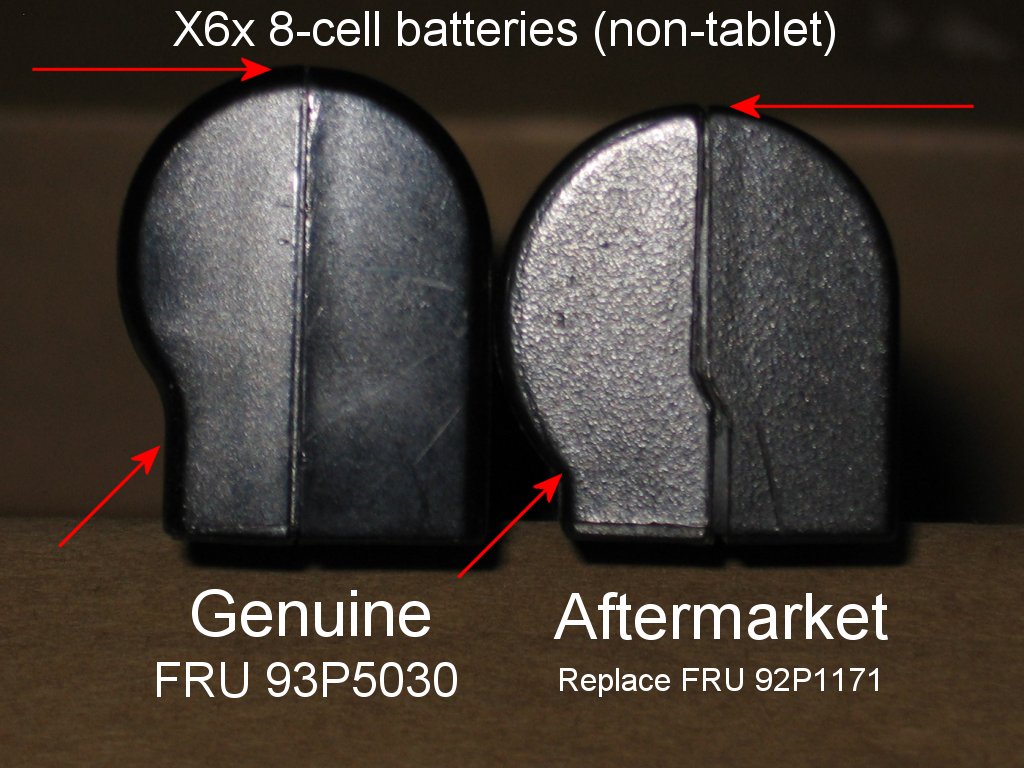

What I said about some aftermarket 8-cell X60/61 batteries not fitting when attempting to attach to the Ultrabase, is with the non-tablet systems; the only type of X6 Thinkpads I have. I do have one knockoff type that does work but my experience is that is the exception rather than the rule. Here's a better photo showing the difference between the two:
Image<--- click for 1024x768 image

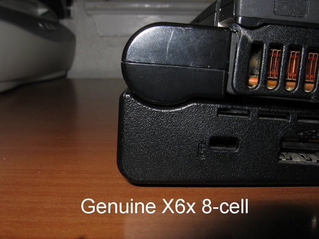

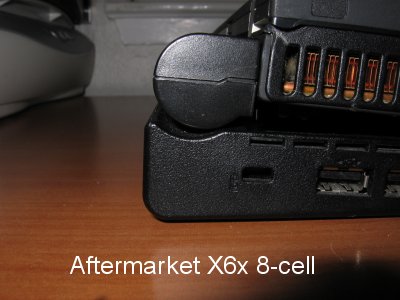

Since the aftermarket cells at the back end do not extend as far as the genuine pack (what the diagonal arrows are pointing to), that part of the extended battery pack does not fit into the matching well in the Ultrabase:

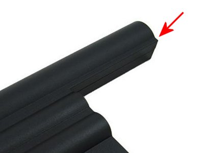

@precip9: I took a look at the eBay listings for "battery x60 (lenovo,thinkpad,ibm) -cmos -spacer -charger -adapter -tablet". By looking at just the 8-cell versions and the included photos, I could only find one listing that appears to be questionable when it comes to working with the Ultrabase: http://www.ebay.com/itm/281144601064 Zoom in on the third and fourth photos and look here:
Image<--- click for 640x480 image
