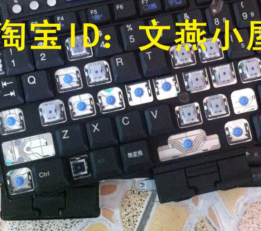

thanks dr_st -- I was thinking the best is likely getting my lazy-*** to simply open up and see the FRU on what I currently have -- guessing it's the NMB but whichever one it is, feels great.
go away.
Re: is there a "better" x6 kbd FRU?
You can remove one key cap and look. NMB should have blue pads like here:
http://img02.taobaocdn.com/bao/uploaded ... em_pic.jpg
