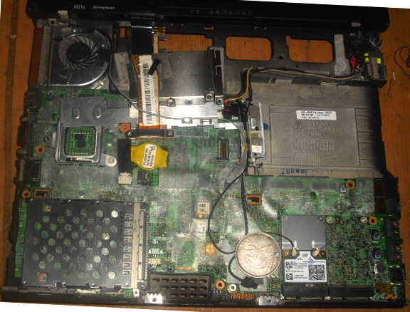

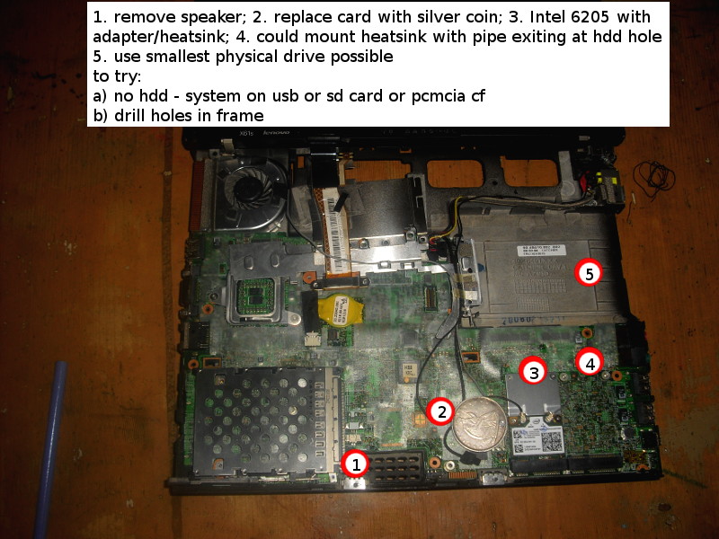

I've got an x61s with an L7500.
It's running Linux and the fan is kept OFF for temperatures under 70C.
Initially the palm rest was uncomfortably hot during idle and web browsing.
Replacing the wifi card with a half-sized Intel 6205 lowered the temperature at the palm rest but it was still too hot.
As I type this the palm rest sensor is reporting 38C. CPU temp is 45C.
Fan has not been on at all since boot.
The changes I've made:
http://www.vettecorp.com/support/downlo ... ore_v6.pdf
TO TRY:
- drill vents into bottom cover
- drill vents into either palm rest or keyboard
- - remove hard drive door
- remove speaker
- wedge the pcmcia door ajar
- remove stickers from bottom of laptop
- remove modem card
- remove one DIMM
- replace wifi with half-sized Intel 6205
- (experimental) use RAM with lower clock rate
- (experimental) add silver coin
- (experimental) place laptop on a bed of desktop memory heatsinks
- (BIOS) turn off multi-core
- cap cpu frequency at 1.2gHz
- lower wifi TX power from 30mW (default) to 1mW
- turn wifi power management ON
- replace HD with a miniature san disk ssd
TO TRY:

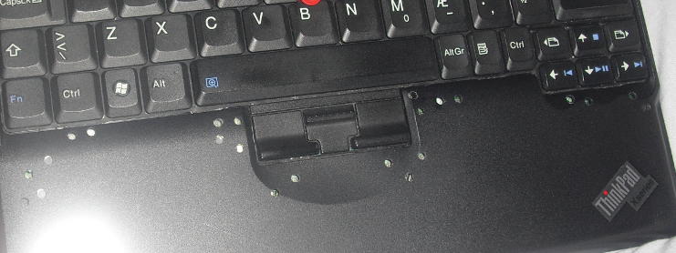

I did some incremental testing as follows:
1. With no user-land power management and with computing idling for 30 minuets palm rest was 46c.
2. Adding a copper plate below the machine lowered temp to 43c.
3. Limiting cpu to 1.2ghz and running power management script and just one core lowered temp to 39c.
4. Drilling holes in palm rest lowered temp to 37c.
next up, drill holes in bottom casing.

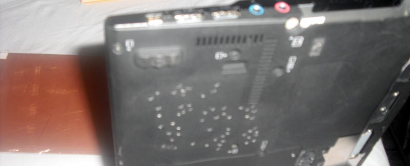

The main way to lower temperature on these machines was uncovered on this forum years ago:axur-delmeria wrote:It would be great if you take pictures of the modifications you've made.
1. replace the wifi card with a half-sized card,

Shows changes I've made inside the case.
http://www.jesseo.com/kites/x61s-palmrest-internal.jpg (168 KB)
Shows 2mm drill holes in bottom of machine. There are 56 holes.
http://www.jesseo.com/kites/x61s-bottom-drilled.jpg (40 KB)
Shows 4mm holes drilled into palm rest. There are about 20 holes visible and an few more which are covered by the keyboard.
http://www.jesseo.com/kites/x61s-palmrest-drilled.jpg (60 KB)
next to try:
- use usb drive or cf and remove hdd
- replace wifi with pcmcia or usb wifi
- add boundry layer / spacer between copper heat shield and palm rest
