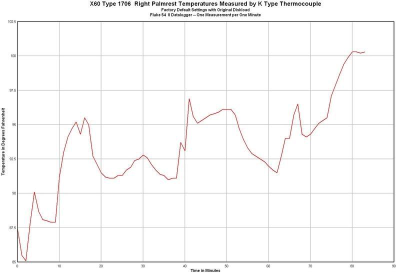

Study Repeated with Original Hardware and Diskload (pic)
#9 Post by Ken Fox » Mon Jan 29, 2007 6:12 pm
Since I had to remove my new 7K100 and extra RAM stick (to be sure that I wouldn't lose them when I send the notebook back), I decided to repeat the study with the original 80gb 5400rpm hard drive and the original RAM of 1gb.
I proceeded to update the drivers and Windows XP, and later did some web browsing with IE and with Firefox (there was no obvious difference in system temp in reference to which browser I used at what time). I also downloaded a couple of large files off the Lenovo website, although stopping those downloads did not reduce the measured temps.
Here is a little less than 90 minutes worth of data:
This is pretty convincing evidence to me that the problem is with the laptop as supplied and not the extra RAM or the 7K100 Hard Drive.
Subjectively, I found the palmrest unpleasant to encounter at any temperature in the low 90's fahrenheit and above, and positively noxious above body temperature (~98.6F).
Ken Fox

This is one of the best documented threads I have seen on this forum. I have one suggestion for you, Ken. Ask lenovo to send you a new system fan and try putting it on. It might just be a faulty system fan - I don't know where the exhaust grill is on the X60, but if it is on the right (like the X31/32), a faulty fan might be a cause for high temps. After I replaced the fan in my X31, it runs way cooler than before - but hey, it was a used X31 to begin with. I don't know if your 21 day return period is up, but if you are out of it, you can think about trying this.

#21 Post by Ken Fox » Tue Feb 13, 2007 2:30 am
pianowizard wrote:Ken, I have forgotten whether the T43's palmrest gets hot.; how warm does yours get? I would like to know because my T60 (which replaced my T43) feels pretty warm even with the wireless card on minimum power, and I don't recall the T43 ever getting so warm. This T60 is not as warm as the X60s that I had, but still a little uncomfortable.
The T43 palmrest is just like the one on my X32; as cool as the ambient temperature in the room. It has a 2ghz processor in it and is not noticeably slower with my usage than my Z or X models with core duos.
For what it is worth, my Z61T is NOT warm on the palmrest even though it has the speediest processor in my little thinkpad collection, a T2500 Core Duo 2ghz. Of course it is that weird 14" widescreen configuration which may have given them a little bit more space to spread out the heat.
I'd be curious to know if other current laptops of similar computing power to the X61 and T60 have similar issues of heat radiating up to places that hands lie in order to type on them and use them.
I never measured high internal temps on the former X60. The highest temp I got on any of the sensors was around 52C. BUT, the heat was radiating out of a place that was unpleasant to be exposed to rather than just going out a side or back vent.
By the way, I continue to like my T43 very much and don't regret getting it over getting a T60 for twice as much. What's more, I can use my old docking station with DVI, which I bought for the former T42, and did not have to buy one of the newer versions for several hundred bucks.

#23 Post by Ken Fox » Tue Feb 13, 2007 11:07 am
gunston wrote:interesting!!!
have a look on my X60s temperature reading...
http://img353.imageshack.us/img353/4884 ... ingzy3.jpg
Those look relatively similar to what I got with the first one, and the right palmrest was either very very warm or almost too hot to use when I got readings like that.
I did not however find a 1:1 relationship with any of those numbers, even the APS number, and palmrest temps.
How does the machine feel when you use it?

#26 Post by Ken Fox » Thu Feb 15, 2007 11:03 am
gunston wrote:well, it warm and still bearable for me.
I did try a few X60/s from my colleagues, they are all relatively got the same Level of Warm here.
what about your APS temp. reading, would you mind to show me?
is it interesting to know, or maybe i should return my X60s to IBM, one to one exchange with a new one?
I don't have a plot of APS temps and I no longer have the offending machine as it has gone back to Lenovo. The highest I saw on the APS measurement was about 52C and at that temp I had my highest recorded palmrest readings with the thermocouple, around 102 degrees F, roughly 39C.
There is no absolute agreement between any of the sensor readings and the actual measured palmrest readings. I think those internal sensor readings are of limited value and it is best to measure the actual palmrest temps with a thermocouple if you have access to one.
I can't tell you what you should do with your X60. You would need to contact Lenovo to find out what your options are at this point. If you have had the machine for more than 30 days, exchange for another one is probably not an option they will offer.
My new one has now been used extensively for 2 evenings. I have not altered the WiFi card settings from the standard "medium" power savings as shipped from the factory. This machine is noticeably cooler than the other one on the palmrest. I have not done any measurements and don't plan to do any as long as it is not uncomfortable.

#30 Post by Ken Fox » Thu May 10, 2007 12:03 am
Further use of the replacement X60 shows that when used with a WiFi connection for extended periods, the right palmrest still becomes annoyingly hot. Not as hot to the touch as the first one I had, but annoyingly hot nonetheless. This is a flaw in the design of this laptop and one that should be considered by those considering its purchase, especially those who will use the laptop with continuous WiFi connections, who don't use a USB mouse, and/or touch typists who type a lot, and will leave their right palms in physical contact with the laptop.
