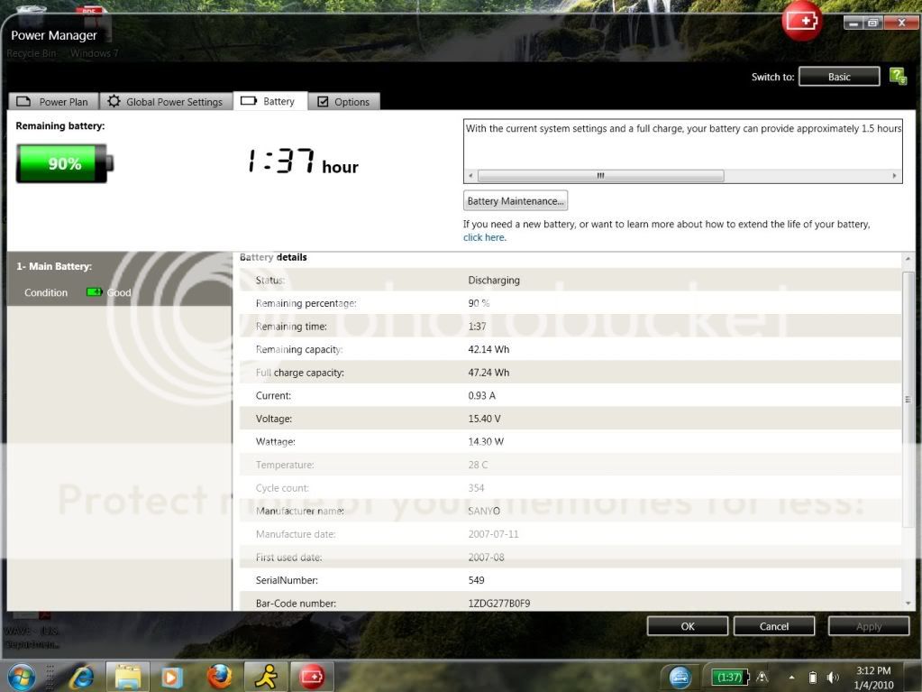

Here are the stats on my battery which is a Sanyo and has been used daily since I bought my X61t in August of 2007. I leave it plugged in all the time at home, and carry it with me to school everyday. It still lasts around 2 hours when I used it on batteries. It has decreased since I bought it, but I've got 2 and a half years out of the thing.
Here is a pic of my power manager.
http://i829.photobucket.com/albums/zz21 ... anager.jpg
Re: Genuine Lenovo Batteries vs. Generic Replacement?
Posted: Tue Jan 05, 2010 12:51 am
by dr_st
Edit:
Based on the current capacity it has to be the 8-cell. The design capacity of this one is 66.24Wh, as far as I know, which means it currently holds ~71% of its original charge. Not bad given the age, the cycles, and especially considering what I've grown to expect from Sanyos. :)
Posted: Tue Jan 05, 2010 2:06 pm
by nblanton
After looking at the thread again, I believe that the folks who are upset about the battery life are experiencing catastrophic failure. I'm happy with my batteries life, and I definitely abuse my laptop. I may be in the lucky minority, or the folks that have had the batteries fail are in the unlucky minority. I doubt that many people who are complaining have batteries that have lasted the way that mine has. I visited this thread to determine what battery I should choose as a replacement, however there doesn't seem to be a very good consensus to help someone make that decision. I'm probably going to shell out the bucks and pick up another Lenovo branded battery. No one has actually recommended an aftermarket solution with more than a single anecdote to attest to the battery quality. And if anecdotes meant anything I would say that Sanyo batteries are excellent, which I believe after reading the thread not to be the case.
Edit: Yes, its the 8-cell battery and according to Power Manager my battery currently has 71% of its original capacity. And if I could get the same performance out of a new one, I would say ~$150 would be well worth it.
