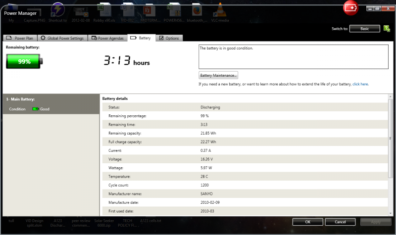

Ok, so the bottom line is...my battery seems to be doing a VERY good job at being a battery. Check out the current status of the battery according to PM:
I'm getting really close to 1000 cycles, and the overall capacity is still at 86% of the design capacity. Is anyone else getting numbers this good??? Just curious! :)

T60 6-cell (Linux OS, data from TLP):
+++ ThinkPad Battery Status (Main)
/sys/devices/platform/smapi/BAT0/manufacturer = Panasonic
/sys/devices/platform/smapi/BAT0/model = 92P1139
/sys/devices/platform/smapi/BAT0/manufacture_date = 2007-05-11
/sys/devices/platform/smapi/BAT0/first_use_date = 2007-08-11
/sys/devices/platform/smapi/BAT0/cycle_count = 1095
/sys/devices/platform/smapi/BAT0/design_capacity = 56160 [mWh]
/sys/devices/platform/smapi/BAT0/last_full_capacity = 48470 [mWh]
86,3 % of capacity left after 6,5 years is rather good. Lenovo "fixed" this though, and X220 battery with Sanyo cells has been a disaster for me.

I haven't done a reset in a while, and I know that with this particular battery it always goes up. It seems to overestimate the capacity loss if not reset in a long time. I rarely go below 20%. The last reset I did was on 5/22/2014 @ 1116 cycles and it was at 24.4Wh or 84.7% of design capacity. I wonder how long this will go for before giving the blinking orange light of horrible sadness?
