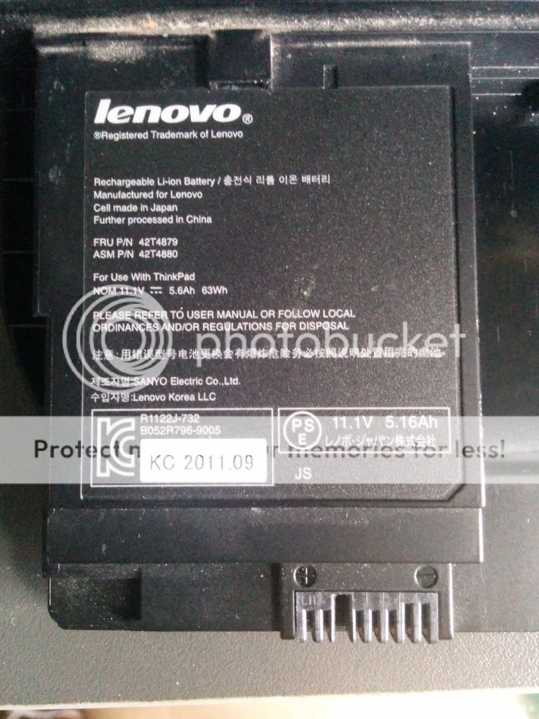

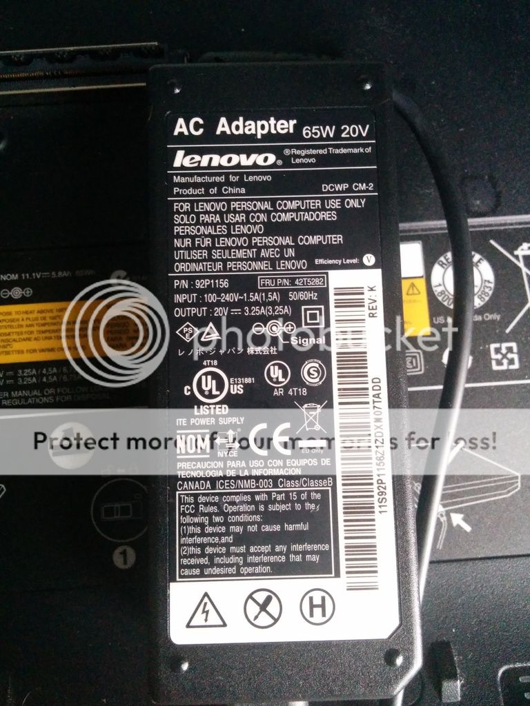

Are the battery and power supply genuine?
Re: Weird Crash where I can't power off laptop on x220 tablet
All components came with the used purchase of the machine. The 'look' genuine to me, but I don't know how to tell exactly? Pics below. The problem came back today and the machine would not turn back on. This time I finally managed to get it to work after doing the secret reset method (power button one second pulses, followed by long power button hold while machine is unplugged without battery). This worked this time but it did not work in the past. I just want to avoid a time in the future where it dies completely...
