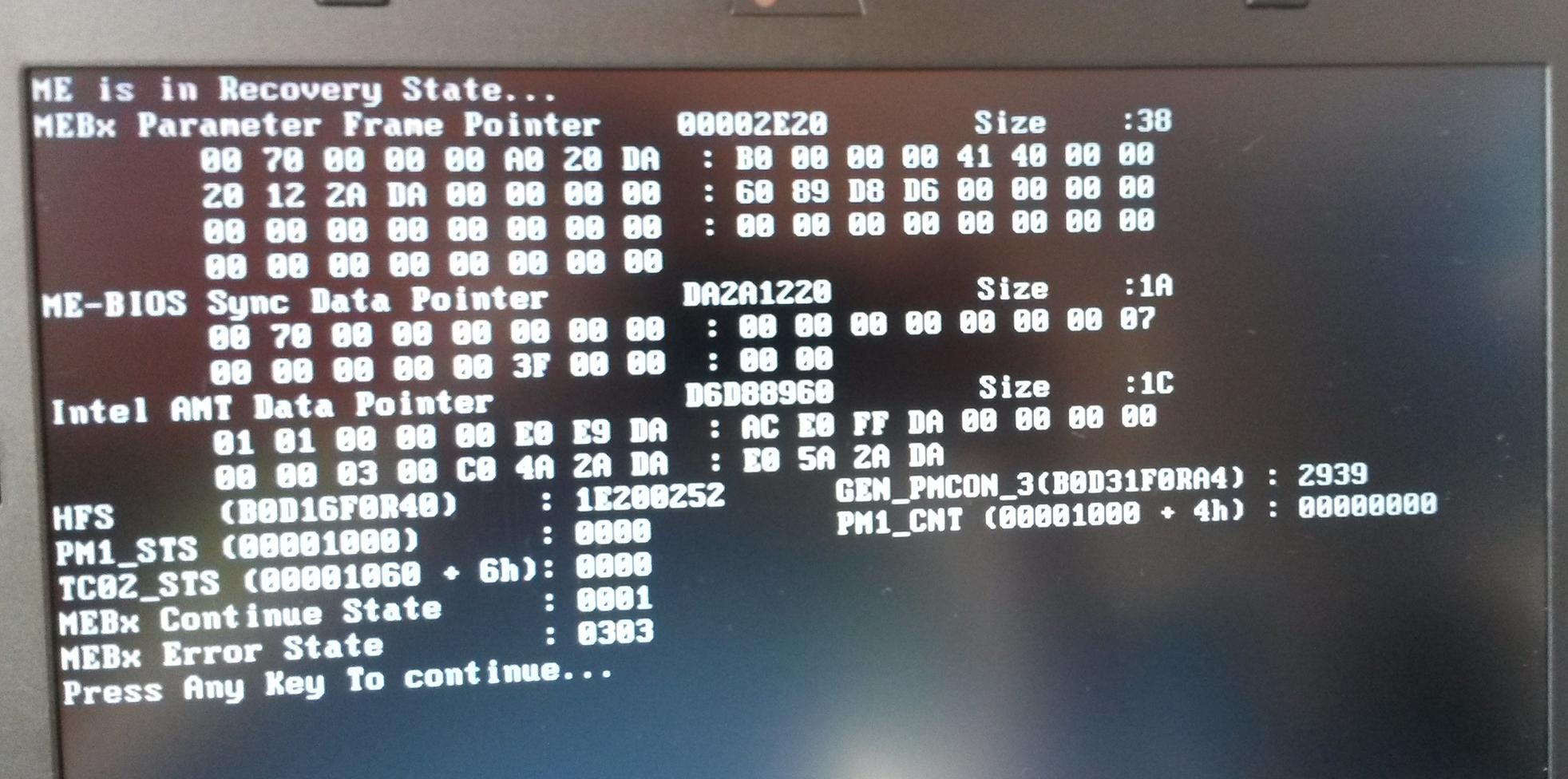

Well,
I did my homework and guesswork! I changed the SPI Chip and programmed it with the content of another X220i, which has installed an older Bios version.
Now, the laptop is booting... BUT
It has the MAC Adress of the copied Machine and it says when booting "ME is in Recovery State".
How can I fix this two things?
Thank you... Hope we can solve this problem!

Re: X220i not booting - only flashing lights
flashing a new bios didn't help, default values included.
When I activated diagnostic Mode, I get the error:
MEBx Error State: 0303
Setting Supervisior Password didn't help either.
Sorry,
I thought I had before posted some summary!
Introduction: I have three X220i form 2011 (11-11-2011). This Model had/ has problems with the bios chip, which lenovo changed for the customers.
Problem: One of the three (the second one is broken now as well) X220i didn't work after a bios update. I don't know it the Bios update was done clean, because I didn't do it. (Installed over Windows, Thinkpad Updatemanager). We think that the Laptop worked after it perfect. (The Second one did, so did the first one would probably)
What is the error? The Thinkpad didn't boot any more, only the leds were flashing and the van was spinning. Then after a short while the thinkpad powered down. No beep.
Chipreplacement: I changed the SPI1 MXIC 25l6406E. Before desoldering I read it and after 4-5 read operations with a programmer, I always got different results on the read bin file.
Then I wanted to erase the chip, without luck, there were some parts where it was not possible to delete the content.
So for me it was clear that the chip is faulty. I desoldered it and programmed the chip with the content of another x220i (will name it now x220i_u) which I have. The Bios of the x220i_u had an old bios version (bios was updated on the machine where the chip was replaced).
After the chip replacement the thinkpad boots up, but now shows the message: „ME Recovery State“. Now there is the "ME Recovery Modus" error and the problem that the thinkpad with replaced chip has the ip-adress of the x220i_u thinkpad!
I wanted to get with Strg-P into the Intel ME Bios but I'm not able to get in there... I tested the default settings in the bios no luck! Made a bios update, no luck! after bios-update default values no success as well. Tested it with setting a supervisor password... no luck as well...
http://fs5.directupload.net/images/170102/2ohtlnwf.jpg
Does this help and do you need any more info?
thank you
I made as well the ME Update no luck...
thank you
cheers
- Posts: 17485
Instead of Strg/P (Ctrl/P) try Strg/S (Ctrl/S)
