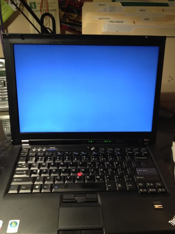

Just happened again. Although the pic shows blue, it's actually a grey screen. In the middle of working, nothing unusual or anything like that. Just goes grey...Any ideas as to what this could be, or where to even begin checking? Connecting another monitor is something that would be possible to do, but it happens so infrequently that traveling as much as I do with this, would be a problem. Also, I let it sit for a minute and did not see the hdd light flicker at all.
