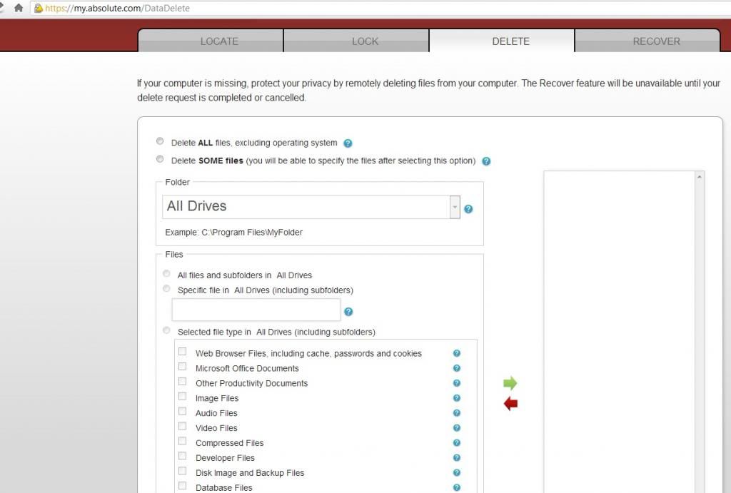

Hi Folks,
I'm interested in getting the computrace software on my T410. I've just realized how silly it is for me not to have the ability to remote wipe my machine, given how much I have on it.
The T410 is advertised as having intel chips that integrate with computrace to make tracking and wiping more secure (i guess). I'm about to buy computrace lojack here: http://shop.lenovo.com/SEUILibrary/cont ... de=0C47795
The service used to be advertised as "Absolute Computrace". I just want to make sure that what I buy does indeed make good use of the intel chips that this thing has.
Anyone else here using this software? I uninstalled the Intel management software from my machine as I don't need anyone managing this for me. Do I need to reinstall that intel software? Any other thoughts?
thanks!

Re: Computrace
Computrace does not need/use Intel AMT. Intel AMT is for central management of a group of machines. The thing that is most important to protect is your data. On modern drives, drive passwords are encrypted and are the hardest security measure to defeat. I never say that anything is absolutely secure. I'm sure if the CIA wanted your data and disassembled your drive, then examined the platters with an electron microscope, they could get in, but nothing I have is THAT important. The machine needs to be connected to the internet for computrace to tell the thing to wipe your drive. By then, if you don't have a pw, it could be too late. For me, the pw is enough

Hi all,
Thanks for the replies. I'm not worried about the CIA. I am worried about laptop theft that turns into data theft. Yes, an encrypted drive (either hardware or trucrypt) would be the best solution. Perhaps I'll implement that in my next laptop. That's not going to happen right now, though. I purchased lojack and that has put me at ease. Not a perfect solution, but better than nothing. There's a chance I'll be able to wipe my data if my laptop is stolen now.

Re: Computrace *PIC*
you're right - sorry for the sarcasm.
I should have put it more simply: yes, an intelligent thief after your data would take the drive out. Are all thieves intelligent, and are they all after your data? If they're just after hardware, that doesn't mean they won't poke around to see what they might be able to find. I will strongly disagree with you about those kinds of thieves not being anything to worry about. My email client lives on my laptop, and a bunch of other stuff. I'm sure someone who isn't an expert of any sort could find stuff in there I'd rather they didn't.
I should also have pointed out more nicely that, while encrypted drives are surely great, it's not happening in this case, so please stop recommending them.
A false sense of security is a danger, but i'm not going to be leaving my laptop hanging around unattended any more than I would otherwise. And furthermore, it isn't "false" to say that there's a chance you'll be able to wipe your computer remotely if you have lojack installed and the comp is stolen. You just have to recognize it's a chance, and not a guarantee.
Anyway, whatever, my question has been answered. Sorry for my previous snarkiness.

a warning
im astonished by "I'm interested in getting the computrace software on my T410.".
You never have read this?
best regards from germany, fakeraol
- http://exploiting.wordpress.com/2009/09/11/138/
- http://corelabs.coresecurity.com/index. ... he_Rootkit
- http://www.securelist.com/en/analysis/2 ... _Revisited
- Posts: 17510
For those in the know: it is relatively easy to deactivate or even remove Computrace.
AFAIK Computrace is limited to only work on machines with M$ Windows.
In other words: install Linux and give Computrace the finger!
Disabling is easy, but not the most important point.
The sessionkey for encryption of the current conversation between c-agent and c&c-servers will be transfered unsecured. That means, man-in-the-middle can not only read the whole comunication, but take full control over your computer because of the design-flaws of computrace by "absolute software".
the jumping point is: computrace lowers your security.
