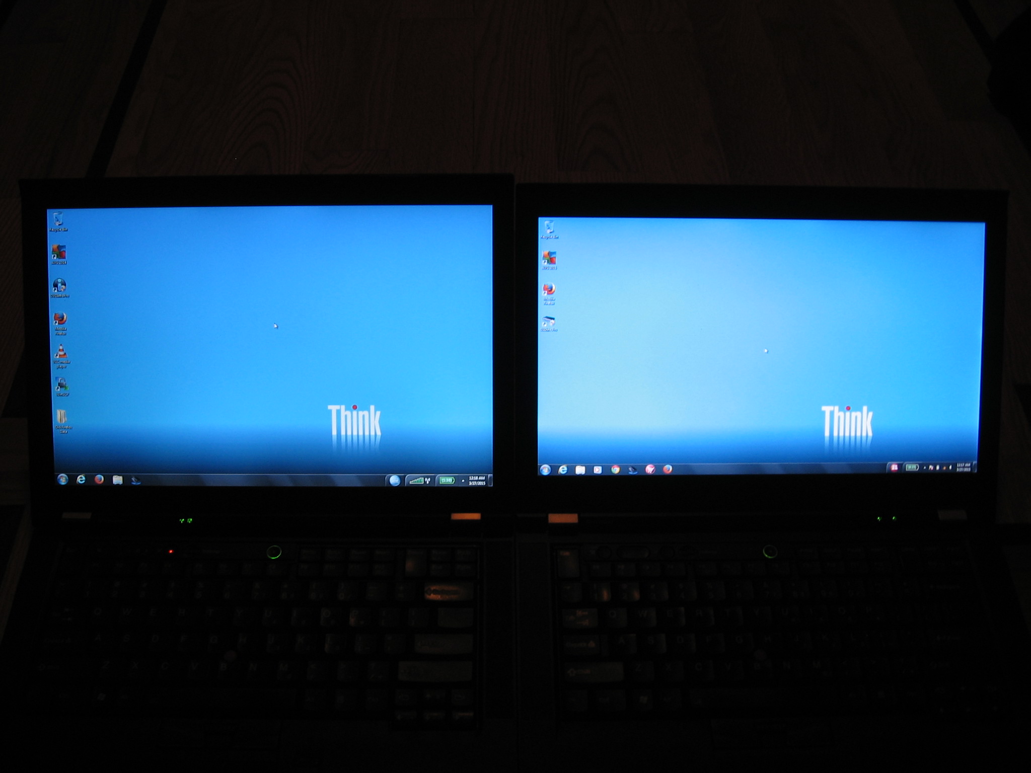

#1 is Windows 7 desktop. You should notice right away that the T420 has a "shorter" screen.

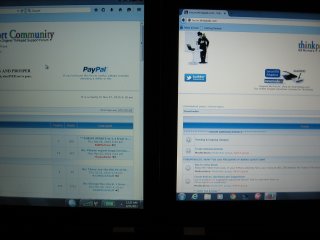

#2 is Firefox browser. Both of these screens have 900 vertical pixels but the T420 is shorter than the T410. This means that the type and icons on the T420 will be a little bit smaller than the T410.

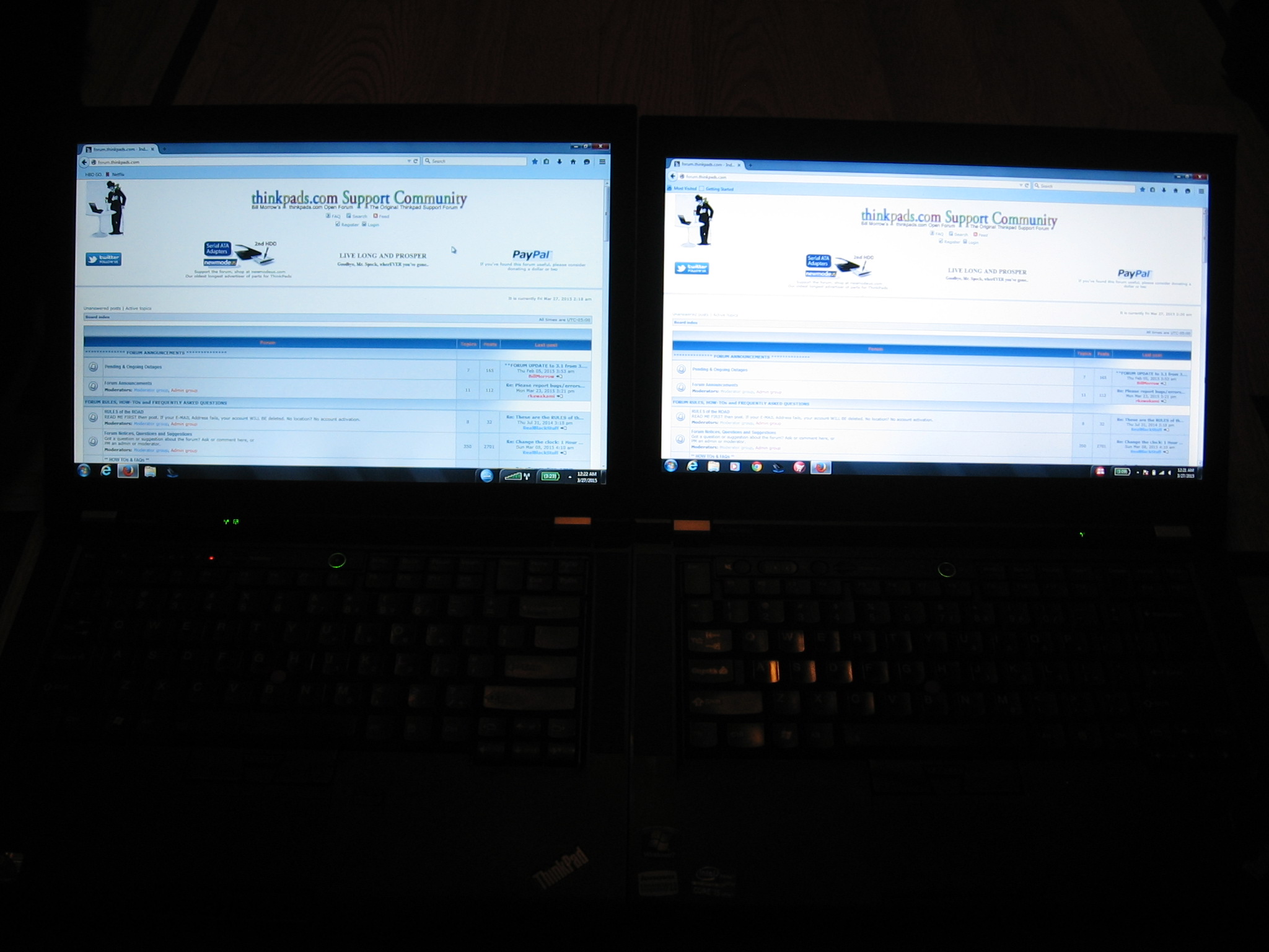

#3 is a closeup of the Firefox browser.

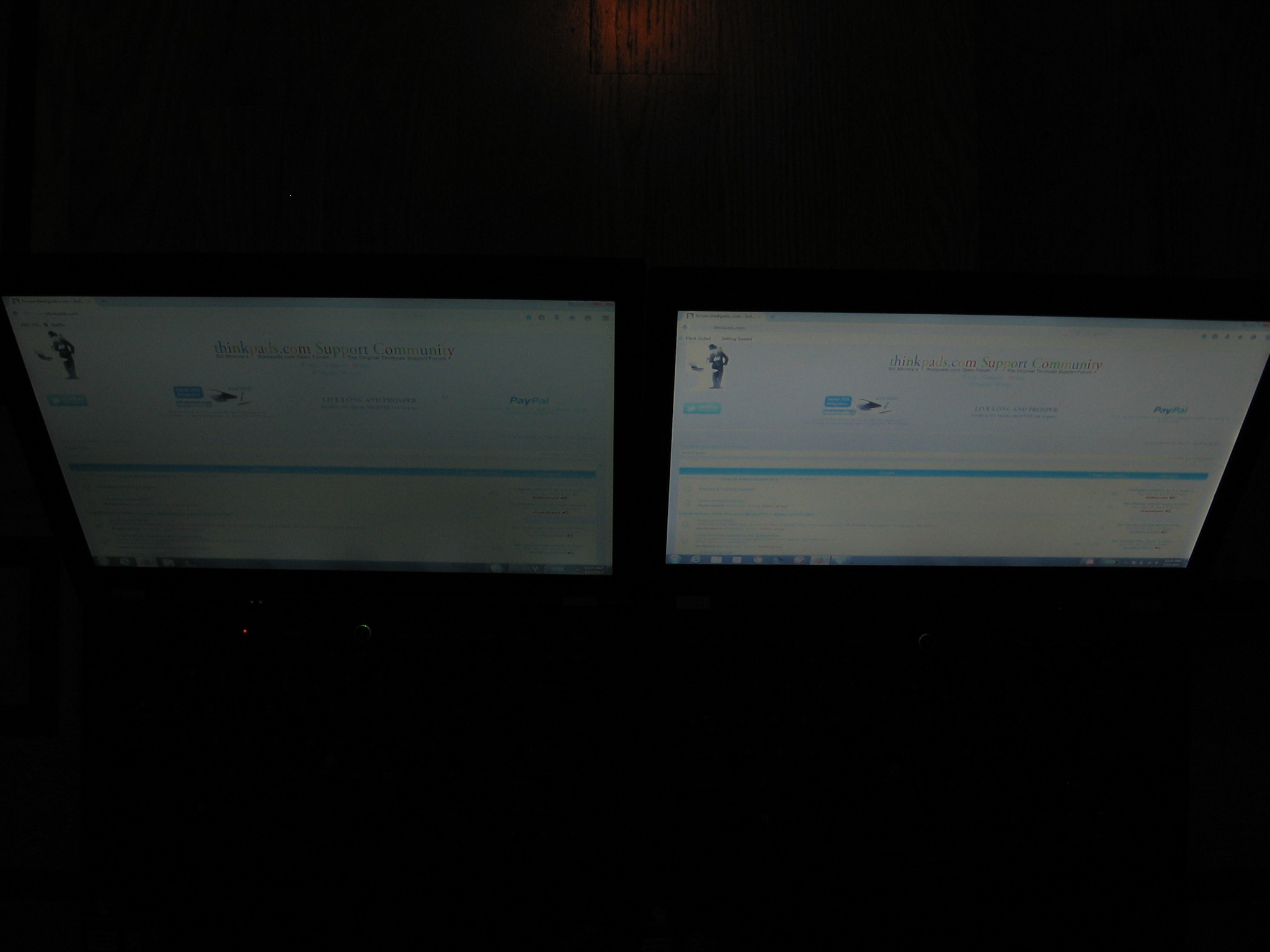

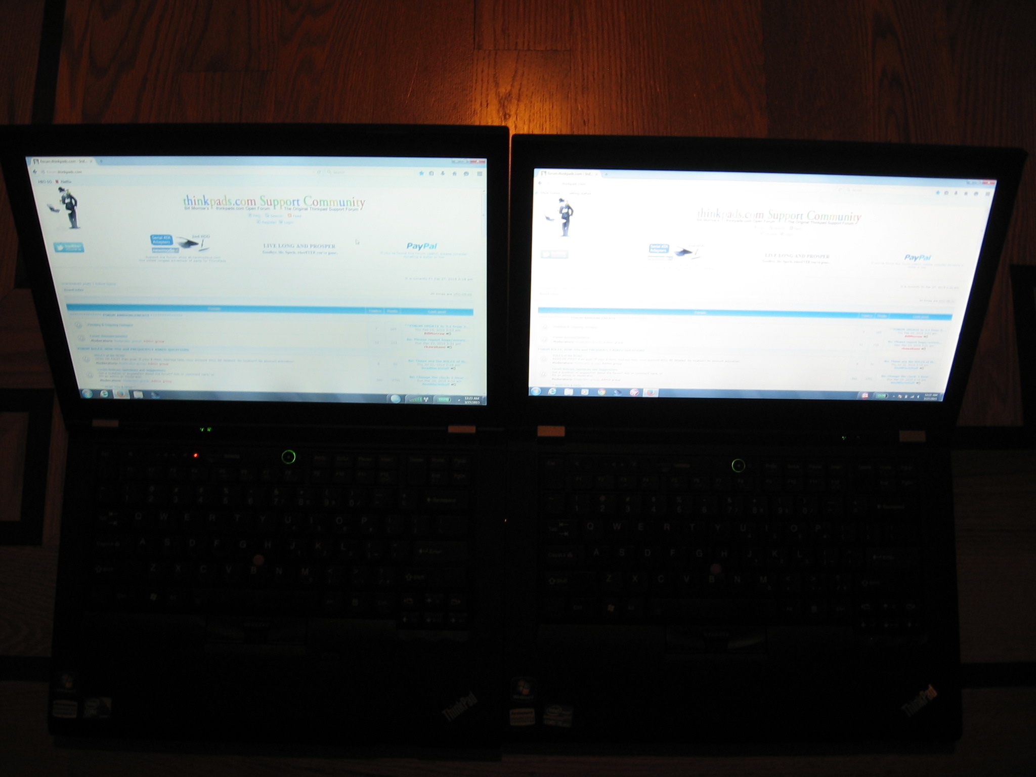

#4 is an offaxis view from above the screens. The T420 screen may be washed out compared to the T410 due to it being slightly brighter.
#5 is a similar view to #4 but I've adjusted the camera's exposure. Both screens were set at maximum brightness. The difference here I believe is due to the smaller aperture ("f-stop") I set on the camera.
