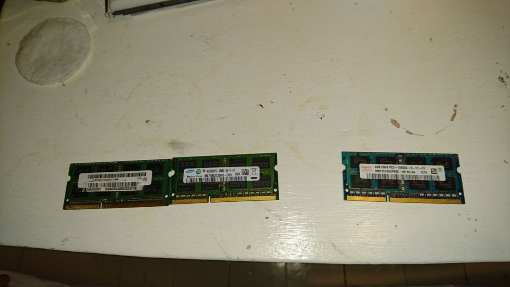

Here are the ram. Old to the left, new to the right. I can't tell from the labels if they are the same Hz
http://i21.photobucket.com/albums/b285/ ... .13.20.jpg

Did you try to boot with only one old ram stick installed, does it boot then? Flip the left one around to see if it has same markings as middle stick (2rx8 pc3-10600s)

They all say 2Rx8. I can't test anything in the T410 since it's completely dead.
I cleansed the RAMs as suggested and did some more A-B testing. Turned out that only one of the old RAM blocks was faulty (the middle one)
I now got the system up and running with 8 gigs :)
