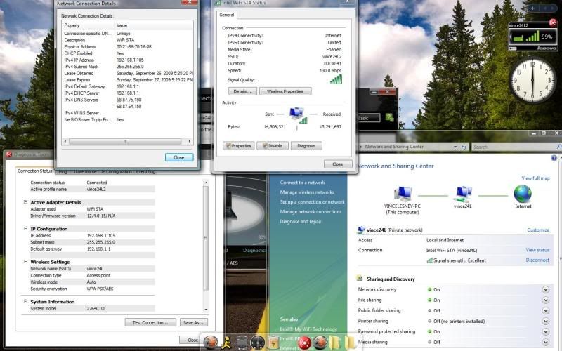

Heres alot more info, Hopefully this will better help you guys:
Yesterday I received my new Lenovo T400 in the mail. I'll start off by saying on a scale 1 to 10 with computer knowledge I'm probably a 5. I'm about average at best. I made sure every driver was up to date. And for awhile I thought it might have something to do with IPv6 being "Limited". As I've read that causing problems at times. Well I unchecked that in options and also what should have shut it off completely in command screen. Still says "Limited" But then read that has nothing to do with IPv4 being slow.(IPv4 says "internet" obviously).
Specs for laptop:
Intel Core 2 Dual T9600 2.90Ghz
4GB RAM
64-Bit Vista Business
Intel 82567LM Gigabit Network Connection
Intel WiFi Link 5300 with PAN
-I'm using Comcast Internet. On my old laptop I was getting around 16download/8upload
-I'm in Aliquippa, PA(Outside of Pittsburgh)
-The problem is constant since I got my computer yesterday morning.
-I am running off a Linksys WRT160N N-router wirelessly.
-My computer didnt come with any anti-virus software so nothing on. I have firewall turned off. And all settings for power set to performance max.
-I'm on 64-Bit Vista business
-Speed tests from speettest.com showing anywhere from 0.16-3download/3-6upload.(Old computer was always around 16d/8up
-I'm using firefox as the browser. I did a speed test on IE as well and turned out the same.
Heres some screenshots if that will help:
img]http://i79.photobucket.com/albums/j138/ ... canyee.jpg[/img]

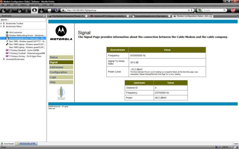

MTU 1500 should be fine for Comcast cable. Open up a web browser (Internet Exxplorer is fine). In the address box up top, type the following, or just click on this link;
http://192.168.100.1
Do a cut and past (or screenshot) of the entire 'Signal' screen. Post it here. I'm particularly after your upstream and downstream power levels. By the way, I didn't see anything wrong with the previous screenshots.
Re: New T400.. Wireless speed 0.14????!?
No, that is your router config. I need to see your modem signals. It should be at http://192.168.100.1
Your signals look OK. Here' s an explanation of what is acceptable;
