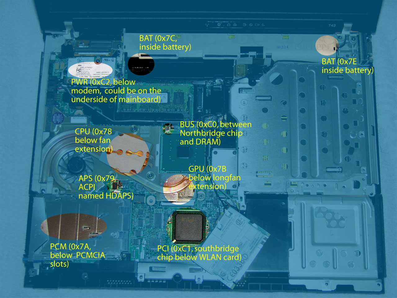

A world first, because nobody decided to *actually* show the insides of a T410.
http://img707.imageshack.us/img707/3799/dsc2182w.jpg
Chassis (Everything in place)
http://img696.imageshack.us/img696/8835/dsc2176.jpg
Chassis (Heatsink removed!)
http://img243.imageshack.us/img243/3262/dsc2174.jpg
Keyboard (No, there is no flex. If there is, see my followup post on how to fix that. I type 150WPM so don't call me a liar, especially with my Model M and Model M13.)
http://img248.imageshack.us/img248/3074/dsc2172o.jpg
Heatsink (Facing up)
http://img232.imageshack.us/img232/2488/dsc2171.jpg
Heatsink (Upside down)
http://img33.imageshack.us/img33/5381/dsc2170.jpg
Bezel (What is this about weak mesh? Bullpuckey, those holes are durable.)
Seeing none of the review sites would do this, I decided to do this.

Resolving some of the "problems" with your T410 (Ex: Creaking) Part one of many!
DO NOT USE A POWER TOOL, EVER. YOU MUST USE A SMALL SCREWDRIVER AND BE VERY GENTLE, IF NOT A TORQUEDRIVER FOR SAFETY.
RAM door seems to be arching/buldging out?
Remove the screw retaining it, pop it out of the slot. Insert it on the opposite side from the screw at an angle, ensuring it properly seats with the funky clips. Align the screw and ensure BOTH plastic tabs on the sides ALSO firmly seat. Tighten the screw to torque spec but do not hamfist it.
Keyboard flexes, especially for the escape key or such?
Remove the RAM slot door, remove the keyboard retaining screw, remove the keyboard. See the small pieces of metal that poke up? Lift those slightly, they may of been bent flat. Do one more thing, run your index finger over the top left area of your keyboard bezel. Does it flex? If it does, see the hardware maintance manual. Remove all the screws associated with the keyboard bezel. Push lightly on the left side of the bezel (Near the speaker mesh) and make sure it firmly seats with the lower body plastic. Retighten the screws to torque spec or SLIGHTLY more. The area where the fan is should be extremely firm now (I kid not). Replace the keyboard, your flex will be gone now.

Fan and temperature:I have reported that the T410 can reach 91C, but that was before I blasted the heatsink and had clouds of dust come out... Right now fully loaded it doesn't seem to want to exceed 70C.
May 14, 2010 tables
Standard cooling
Level=36 128
Level=41 0
Level=42 1
Level=44 1
Level=45 2
Level=46 2
Level=48 3
Level=51 5
Level=57 6
Level=66 7
Level=72 128
Aggressive cooling (Kind of obsolete now.)
Level2=38 0
Level2=42 1
Level2=44 2
Level2=45 4
Level2=46 6
Level2=56 6
Level2=62 7
Level2=64 128
Low "fan noise" profile, you have a bit less thermal inertia since the fan won't be cooling to 42-44C.

http://www.thinkwiki.org/images/6/6c/T4 ... ensors.jpg
From a structural point of view, you want to put holes in there for strength and weight savings. Also in terms of cost savings, Lenovo would be better off in removing all the LED indicators. (You're talking about grams of metal being removed here) The costs to make those holes in the first place by tools (Including replacements as said tools wear out head to grin...) would cost more than whatever amount saved. Alternatively those are forged/cast into place (Which makes sense).
