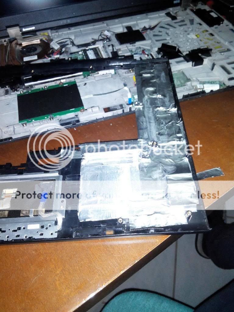

You have understood well, don't worry about the keyboard, the thermal pads doesn't transfer very much heat, but it help to keep temperature down.
That alluminum tape is an attemp to improve the heatsink surface, not tested yet, i would keep the fan always stopped when i'm over ubuntu. This evening i will test it, bye

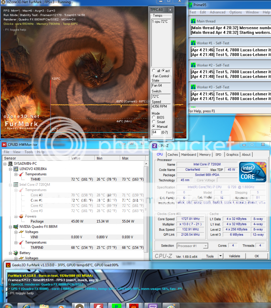

Can you do the test with both version of furemark and prime 95 for an hour as i've done after? So we can make a comparison.. Bye

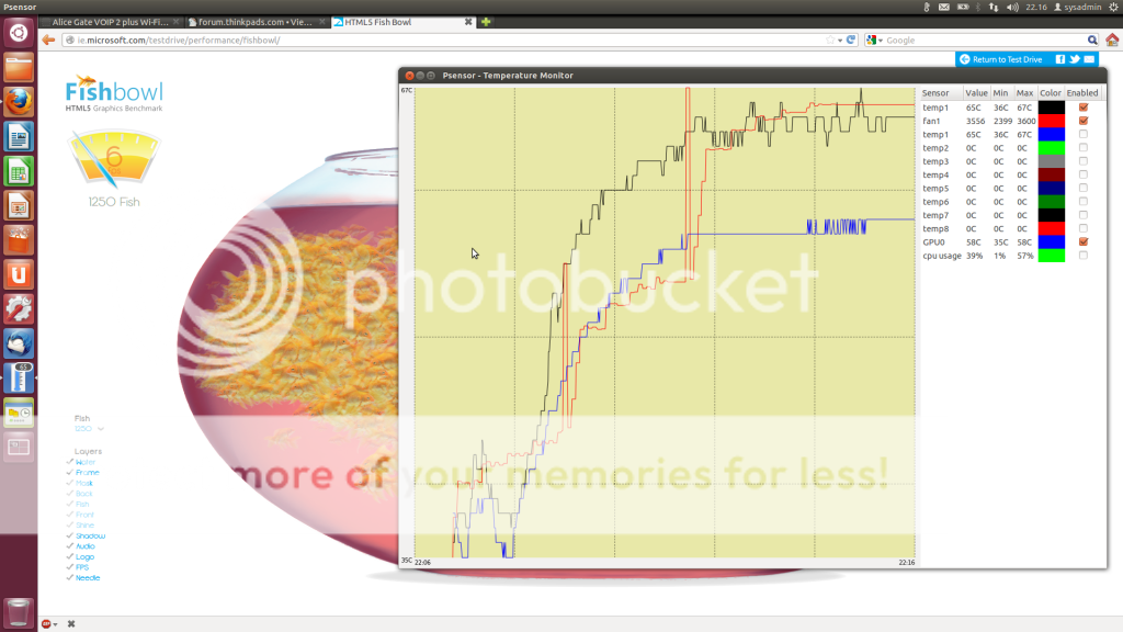

here is mine :wink:
please try the same test, otherwise we can't understand which way works better.
I'll try 'even your system in addition to mine, I want to see if I can go to 50C :D
http://i943.photobucket.com/albums/ad28 ... g~original

Looks very good, I will have to get the other W510 cooler sometime, so that they can be compared under the same conditions.

Adda wrote:Looks very good, I will have to get the other W510 cooler sometime, so that they can be compared under the same conditions.

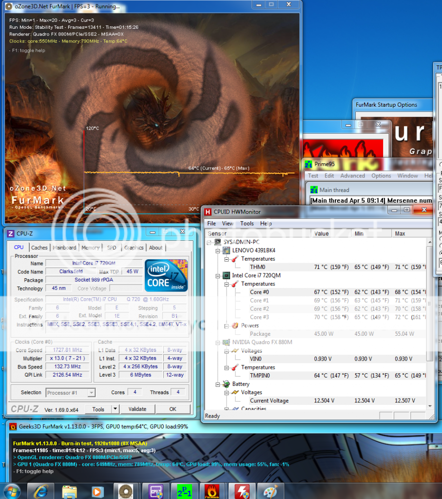

here is over ubuntu, with flash test without any fan control program

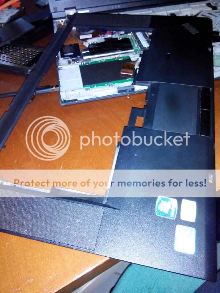

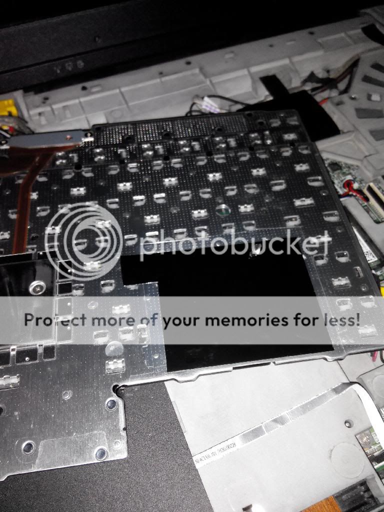

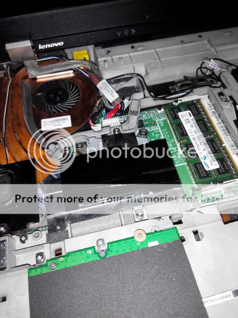

maybe now I can be happy, I have removed the metal sheet on the processor, it seems that finally the temperature begins to go well

I lined the part of the heatpipes that is exposed to the underside of the keyboard, using a thermal pad from a T43, cut in half (used both halves).
The pads are in a single layer, I removed that metal plate, I did not remove the plastic backing on the keyboard in the area above the thermal pad.
It seems temps has been lowered by 2-3C for both CPU and GPU, so the CPU doesn't exceed 75C, GPU stays below 69C.
I did not do a single core burn this time, I don't think it is necessary at this point.
Re: 3d games over w510
Posted: Sat Apr 05, 2014 1:43 pm
by aldimeola81
Adda wrote:You still have something between the CPU and keyboard right? only difference is you removed a layer?
yes, i've removed a layer and moved the termal pads, i've added some thermal pads over the cpu and other over gpu.
you wrote that you've lowered the voltage of the GPU, how you do it? using ntune or what? bye
Posted: Sat Apr 05, 2014 1:56 pm
by Adda
To undervolt the GPU first get "PowerMizerManager":
http://nvidia-powermizer-manager.software.informer.com/
Use it to force the GPU to stay at a constant power state, rather then dynamic scaling.
Max perf = 0.93v
Med perf = 0.85v
Min perf = 0.8v
You can set different power states for AC and DC, so why not put the GPU in to it's minimum power state when on battery.
Then get nVidiaInspector:
http://www.guru3d.com/files_details/nvi ... nload.html
Use it to overclock the GPU, remember to select the correct power state in the overclocking menu (P8 if you run at 0.85v).
Shader clock should be core clock x2.2, I don't recommend overclocking the video memory, just put it at 790MHz.
To apply overclocked settings at startup, right click the "create clocks shortcut" button and select "update startup task".
I think you can safely overclock to 575/790/1265MHz@0.85v (core/mem/shader), beyond that you'll definitely need to test rigorously to be completely free of artifacts or crashes (real world gaming, synthetic tests are better for temperature testing).
