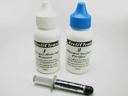

theterminator93 wrote:Q-tips and rubbing alcohol (90% or higher concentration) to clean the old grease from the heat sink and CPU/GPU dies before you apply paste.
I have this kit, http://ecx.images-amazon.com/images/I/4 ... SX425_.jpg Will this be okay as a alternative to the rubbing alcohol?

The kit you bought looks like one of the "overcomplicated" methods for applying paste. It should do the job just fine, but isopropyl alcohol would have been cheaper. :)
