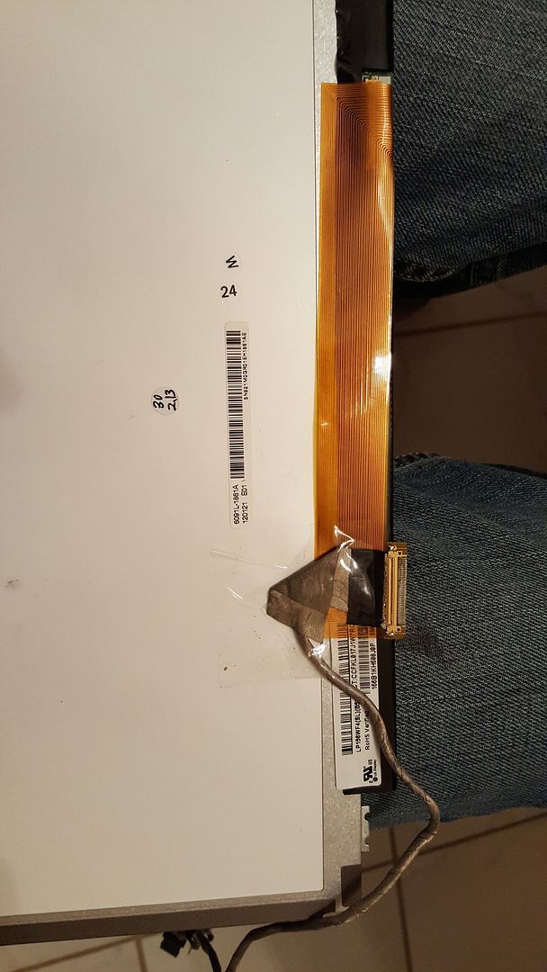

Edit: Here we go... just bought the panel and a 40 pin connector extension cable. I'm optimistic about being able to make this work without too much hassle.

I actually ordered this one. Not sure how long it'll take to get here, but should be within a week I'd imagine.
http://www.ebay.com/itm/321599646387?_t ... EBIDX%3AIT
It doesn't explicitly state LVDS but I counted to be sure it had 40 pins before I pulled the trigger...

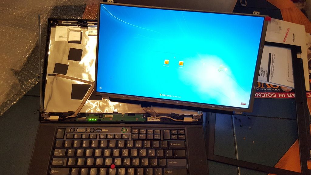

Re: IPS Screen possible in W520?
Posted: Fri Dec 11, 2015 7:46 pm
by theterminator93

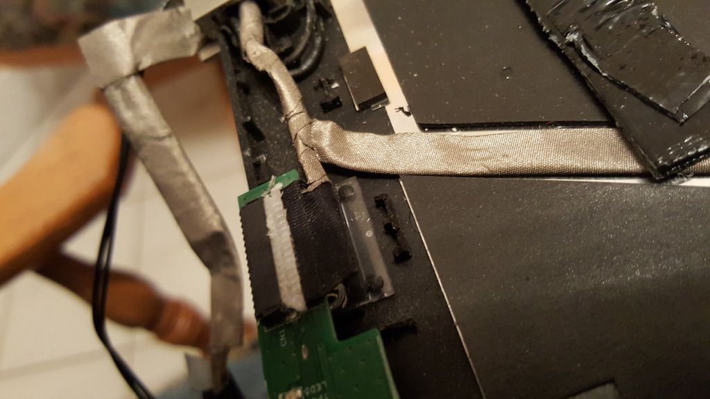

Well, the good news in my case (aside from the screen being "Plug and play" as far as electronics goes), is that the screen fits perfectly in between the two rails in the LCD housing - about 2.5mm of foam padding or similar behind the screen will keep it flush with the front bezel, and securing it to the rails could be as simple as some high strength adhesive or tape. I'm hesitant to use butyl tape or other double sided tape to secure the screen to the back of the LCD cover because I want to be able to remove it later if necessary.
The only physical conflict with installing the bezel over the screen is the microphone/LED board, but that's not a "mission critical" item and if needed, can be modded with relative ease. If I wanted to I could put the panel in there as-is and just live with the screen being slightly off-center - but I'm a bit neurotic when it comes to doing any sort of modifications. Unless it looks convincing enough to look factory, I am usually hesitant to do it. The new LCD mounting tabs don't look like they're in the way of anything so I might not need to cut them off. Not sure yet.
I bit the bullet on a T520 top cover assembly for a touch over $20 which I hope to use as my fitting test platform. I am going to try and modify the LED/microphone card or its mount in such a way that I keep the functionality of the microphones (I am willing to sacrifice the center screw for the front bezel), then see what kind of metalwork is most feasible so I can get the screen bumped about 1/8" to the right. It am hoping it will be as simple as cutting the top half of the arm out so I can slide the screen "through" it - then I can fairly easily braze the removed portion of metal to the bottom portion to reinforce it so it's less likely to bend when the angle of the screen is changed. In theory, the only tools required include a rotary cutting tool (e.g. Dremel) and an oxy-MAPP torch with some brazing rods...
I did think about fidgeting with/transplanting the frames, but I'm not ready to destroy two otherwise perfectly good screens in pursuit of this goal...
Keep on wishing me luck... :)

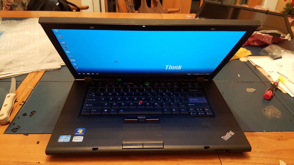

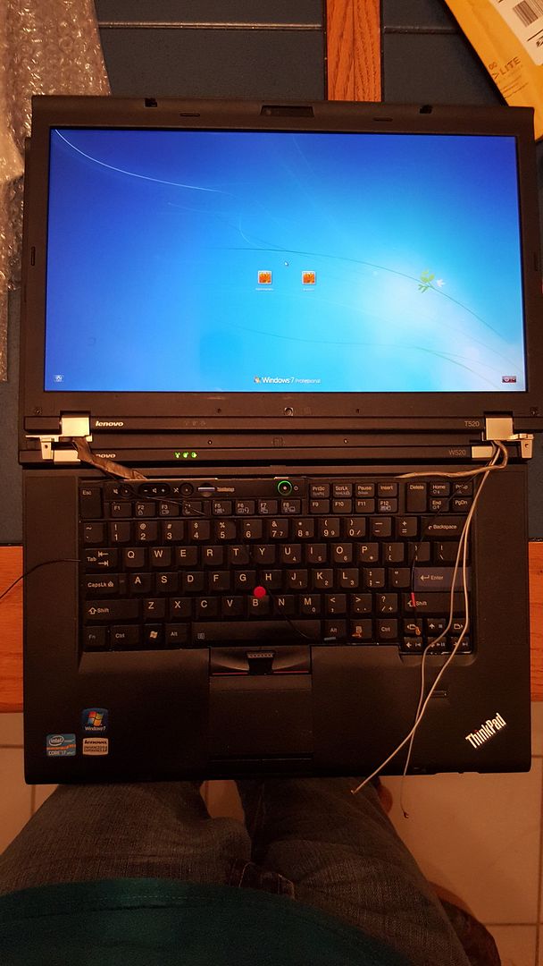

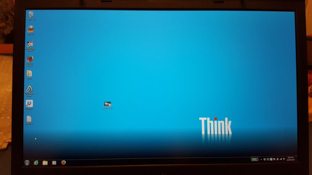

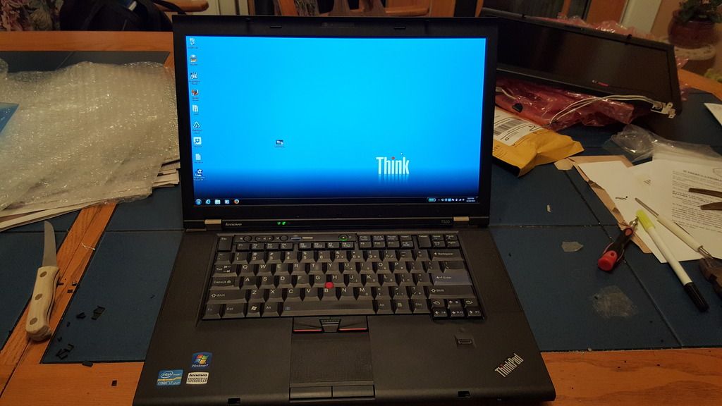

Posted: Sat Dec 19, 2015 6:50 pm
by theterminator93
A little teaser while I button things up... :D
http://i60.photobucket.com/albums/h30/t ... awqyjw.jpg

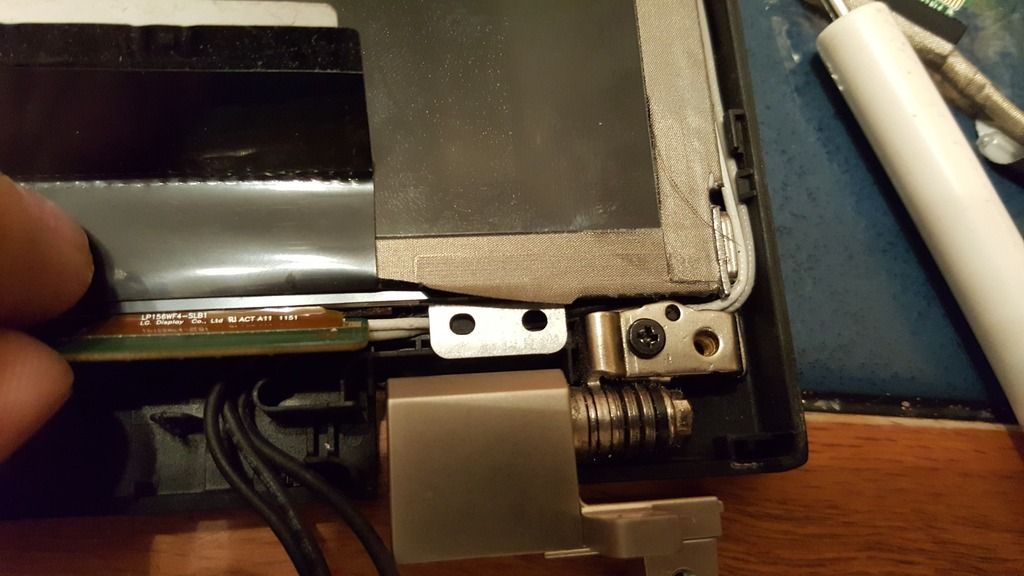

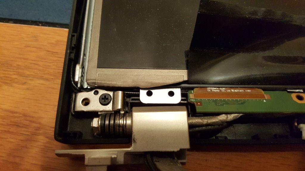

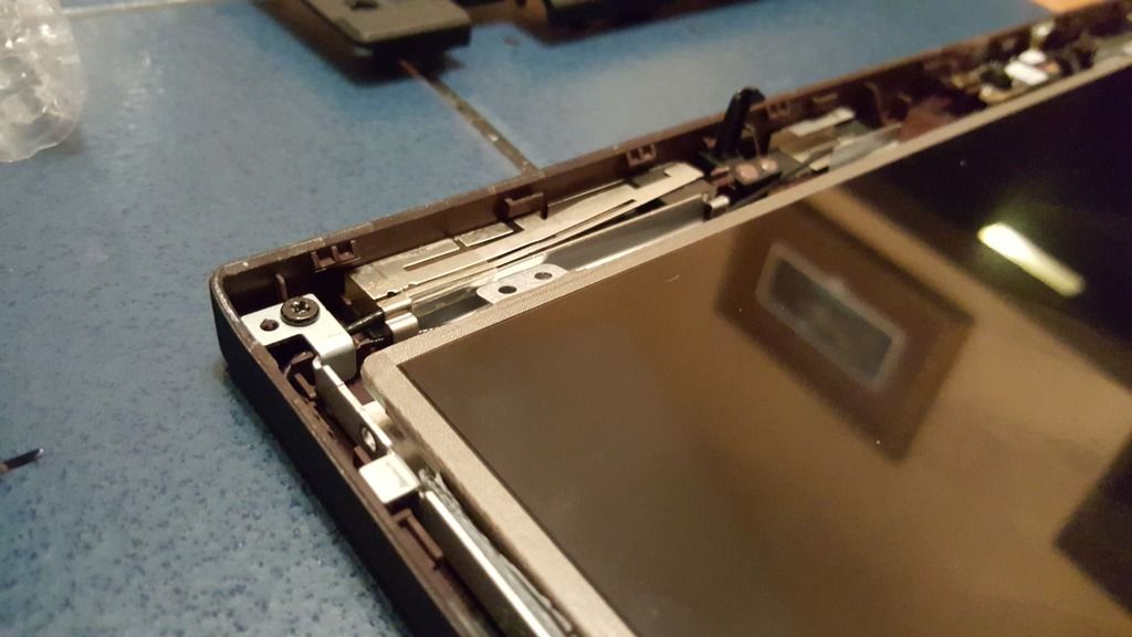

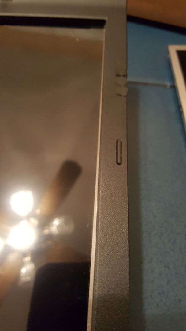

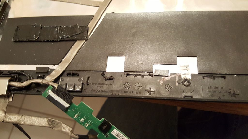

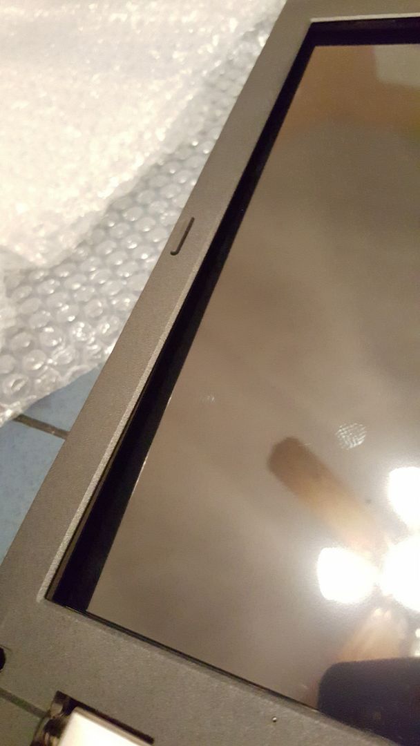

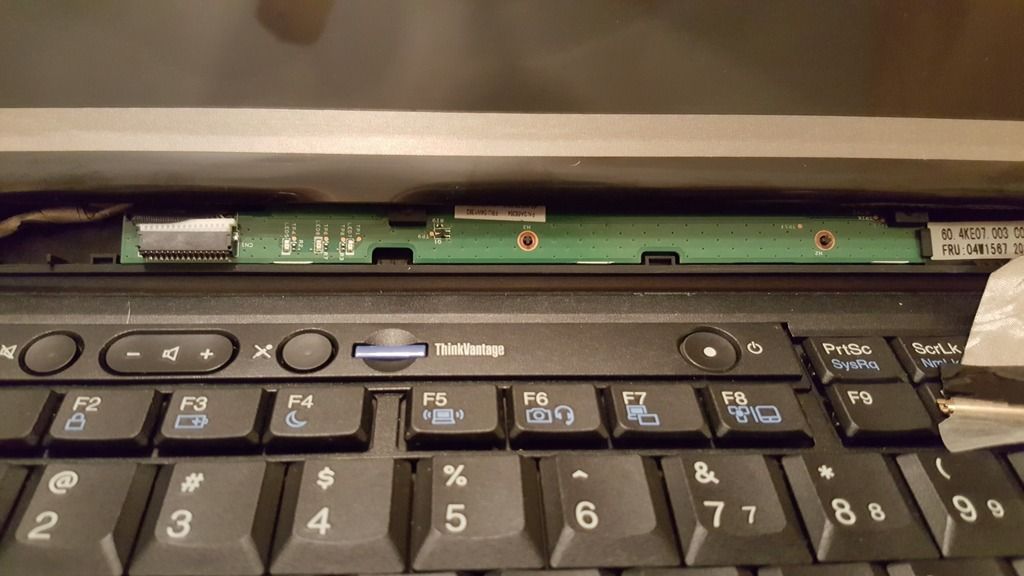

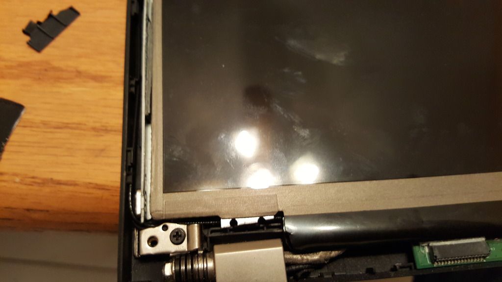

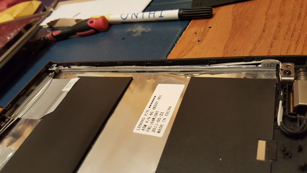

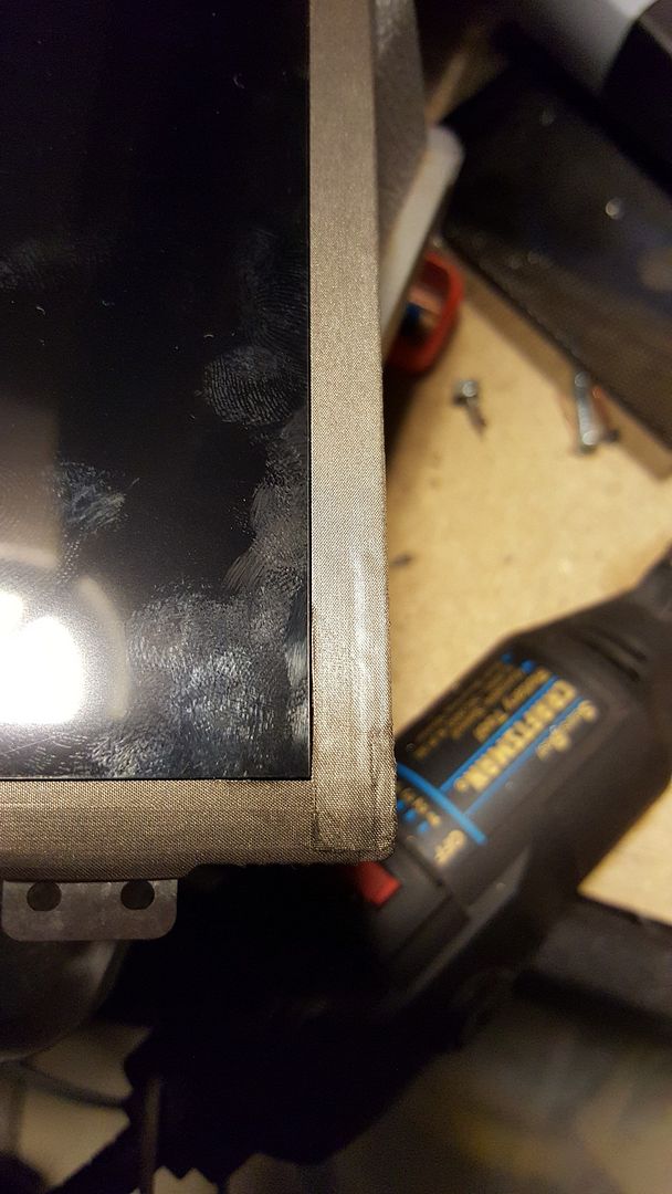

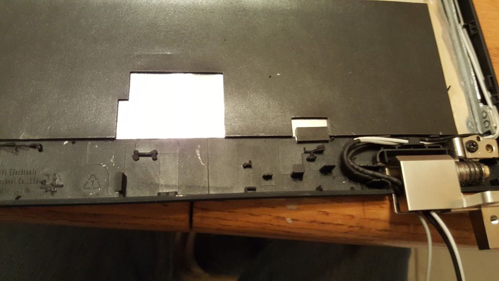

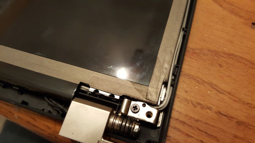

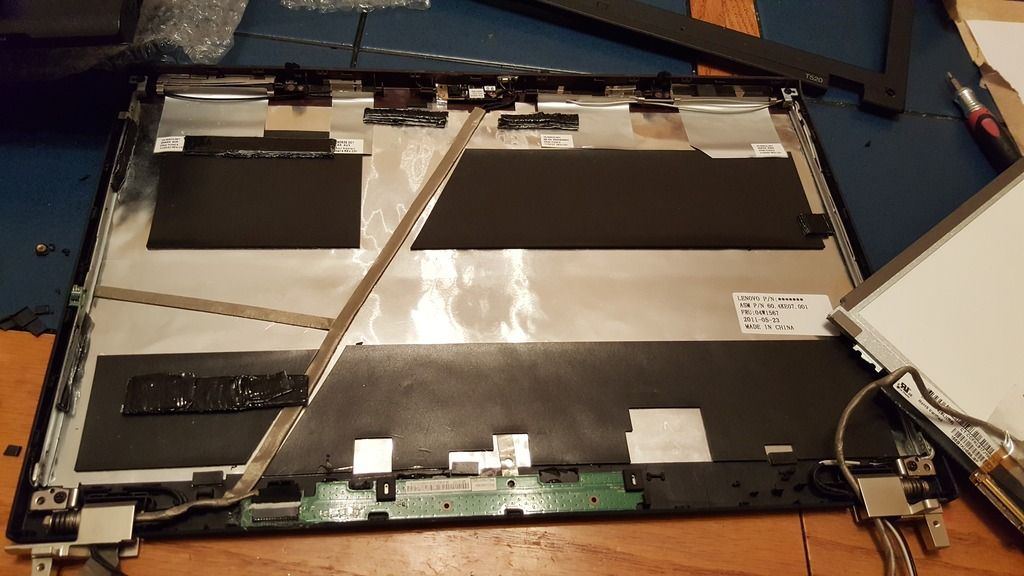

Okay. Here's the "how it was done..." part. :)
I have not yet found a permanent method to secure the LCD to the lid, so I need to take care to always open it with two hands (or open it in the middle of the screen, not on just the left or the right side) or else the front trim bezel pops open slightly at the bottom on either side. The only "casualty" of the modding process was the right microphone, where I accidentally slipped with the Dremel and ground through one of the traces on the microphone/LED card... but otherwise everything works and looks great!
I used an LP156WF4(SL)(B5) instead of LP156WF4(SL)(B1) due to the slightly higher brightness (300 cd/m² vs. 250 cd/m² for other models of this screen; the factory AUO panel is 270 cd/m²). From what I can tell LP156WF4(SL)(B1) through (B7) are all interchangeable aside from their respective color/brightness/contrast characteristics.
Modifications are required to the back of the LCD lid, the front LCD trim bezel, the right hinge, AND the LCD panel itself. All of the modifications are purely physical in nature, but doing any of this requires a good, steady hand as some grinding/cutting is required to make clearance. Also, as was noted above, you will need an LVDS (40 pin) LCD extension cable.
Tools I used included a precision Phillips bit P000 and standard a standard Phillips P0, a hobby knife, scissors, side cutters, a hot melt glue gun, and a rotary cutting tool (e.g. Dremel) with a cutoff wheel and small grinder head bits.
Take off the front trim bezel and remove the right hinge. Use a rotary cutting tool to slice in half, lengthwise, through the long arm of the hinge, from just over the attachment point to the hinge base all the way to just before where the top attaches makes a 90 degree bend. Use a grinding tool to deburr and soften the edges somewhat. Return the hinge to the LCD cover.
http://i60.photobucket.com/albums/h30/t ... wprn9a.jpg
Break off/grind down all of the cast protrusions in the LCD front bezel along the bottom between the two areas recessed for the hinges - EXCEPT the "boxes" around where the three LED indicators go - including the center screw post. Also grind the upper, inner corners of the cutouts for the hinges down by about 1/16" (1.5-2mm), by about 1/16" (1.5-2mm) towards the outside edge but by about 1/8" (2.5-3mm) towards the bottom. This is required because the circuitry of the LCD is ever-so-slightly too wide to fit snugly between the interior plastic of the lid and will need to protrude through the thickness of the plastic. You won't see any protruding of the LCD circuitry when complete though.
Break off/grind down the cast protrusions in the back part of the LCD lid along the center in the bottom, including the removal of the center screw post - EXCEPT the area around where the LED indicators are and where the "cable channels" near the hinges are. Also grind down about 1/16" (1.5-2mm) of the "J" shaped upper cable guides near the hinges on both sides. Do NOT grind down the small tabs at the very bottom; these will help keep the front trim bezel secured when it is installed since the center screw has to be sacrificed. All of this is to allow you to recess the LED/microphone card against the back of the lid and to give the circuitry of the LCD clearance.
http://i60.photobucket.com/albums/h30/t ... hwwrsx.jpg
http://i60.photobucket.com/albums/h30/t ... 4aal9r.jpg
Grind back the top 1/16" (1.5-2mm) or so of the white LED/microphone cable connector. This is to give additional clearance for the LCD circuit card as well. Be careful to not grind so deep as to reach the wires in the connector.
http://i60.photobucket.com/albums/h30/t ... 3fskgx.jpg
This part we will need to modify the shape of a couple areas of the LCD to allow it to fit properly. Use GREAT CARE when using a cutoff wheel here, as you certainly don't want to slip and damage any parts of the LCD that affect the visual quality of the panel! Gently lay the LCD into the lid so that it rests about with a 1/8" (2.5-3mm) gap between the left hinge and left side of the panel. It should be over top of the modified right hinge, but where the base of the hinge attaches to the arm you'll see that the LCD needs to be clearanced. Mark the area to remove, then carefully grind or use a cutoff wheel to remove this section of the panel. Don't go more than about 1/8" (3mm) into the panel from the side as you'll begin to get dangerously close to the electronics in the panel. The outer area you are removing is simply "dead plastic". Return the panel to the LCD cover and ensure it now "drops down" and fits snugly.
http://i60.photobucket.com/albums/h30/t ... m2elua.jpg
http://i60.photobucket.com/albums/h30/t ... s69zsj.jpg
I also lifted off the plastic protective cover over the LCD's circuitry to remove the two small (PH000) screws that held it securely to the panel so that I could break off the mounting tabs to move it up/down slightly. In addition, I clearanced a small section of the circuit board on the bottom left to allow it to clear the plastic edges of the LCD case near that hinge. This may not have been necessary, however based on my fitment trials it would not have fit without protruding from the cover. Again, take great care if you do this...
http://i60.photobucket.com/albums/h30/t ... kbs62y.jpg
http://i60.photobucket.com/albums/h30/t ... oet5gn.jpg
Break off the two lower mounting tabs on the LCD, then bend the upper two mounting tabs down slightly (perhaps 15-20°) but don't break them off.
http://i60.photobucket.com/albums/h30/t ... mm2agd.jpg
http://i60.photobucket.com/albums/h30/t ... quqsk6.jpg
http://i60.photobucket.com/albums/h30/t ... 7lhfjv.jpg
At this point you should have done enough clearancing to test fit the LCD into the cover assembly. With the LED/microphone card in, you may notice that it's difficult to keep the front bezel snapped in place along the middle of the bottom. Since there's no center screw anymore, you can choose to use some double sided tape in this area against the LCD to keep it secured. However, you may also want to consider gluing the LED/microphone card in place such that it is bent slightly in the area of the microphones so it is stays as close as possible to the back of the cover to give room for the LCD circuit board.
To do this, get a hot glue gun and glue the three sides around the LED indicator "boxes" to the LED card under the connector. Then once this has cooled, do the same in a couple areas along the right portion of the card and try to bend the card so that the microphones are as recessed as possible. Don't go too crazy here; you don't want to break the card or lift the area of the card around the connector.
http://i60.photobucket.com/albums/h30/t ... m7st0k.jpg
Now you should get something behind the LCD to help keep it pushed forward so the front of the screen meets the LCD bezel. I used some duct tape layered over itself numerous times, stuck on in key places, to keep the screen pushed forward. I also put a couple thin strips against the left hinge arm to keep the screen pushed to the right. (see photo above)
Now get the LCD extension cable and connect then affix it with tape so that you have something that looks similar to this:
http://i60.photobucket.com/albums/h30/t ... 8eq3dh.jpg
As I mentioned before, I haven't yet decided how exactly I want to secure the LCD to the lid. Feel free to use tape, glue, epoxy, or come up with some clever way to use the original mounts with new screw mounts. I simply tacked a small dab of hot glue to the corners to hold it in lightly until I do something more permanent. I advise you test fit with the trim bezel in place to be sure everything lines up.
Once you've secured the LCD to the lid, route the cable out the right hinge, put the LCD bezel back on, reinstall... and enjoy!!
http://i60.photobucket.com/albums/h30/t ... m5gjab.jpg
http://i60.photobucket.com/albums/h30/t ... pldjup.jpg
http://i60.photobucket.com/albums/h30/t ... 87zaox.jpg
http://i60.photobucket.com/albums/h30/t ... blwljo.jpg

Pretty impressive result :D
since it might not look too easy for some, and not exactly plug and play, I wonder if someone will start selling pre-modded display assemblies :P
