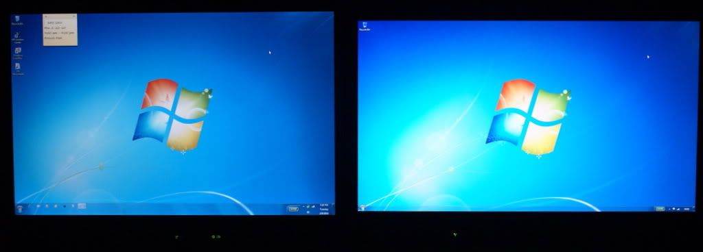

Hopefully you guys won't consider this off topic. I have my W510 in, and of course opted for the FHD w/ 95% gamut.
I did not opt for the calibrator, as I'd rather spend that money on an external one I can use on all my computers.
Here it is against my old W500 WSXGA+, which I sold off to a client to help pay for the W510.
Maybe I'm just not used to what's probably 58% more gamut than the W500, but is there anything for software calibration I can do? Everything looks great, but the green power manager has almost a candy-green color to it. Maybe it's just seeing proper colors when I'm used to limited colors before...but I'd like to make sure .

See what I was talking about in reference to my Dell? Does the Lenovo have any software to run the panel in sRGB mode? If not, I think you are pretty much stuck with over-saturated colors in Windows and applications that don't color manage, meaning most of them.
