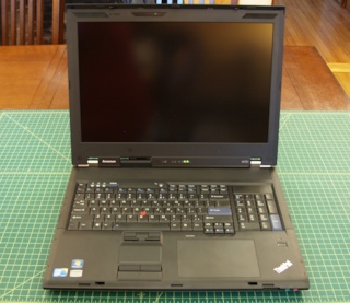

Build quality
Nothing much to report here; solid like my T42p. Some minor body flex with substantial pressure. You can tell the stiffness is inside and there's a plastic shell around it. There are places where the plastic shell deflects slightly before hitting the internal skeleton. Lid flex, despite the extra inches, is about equal to all the Thinkpads I've owned in the past. Every thing assembles and disassembles cleanly. There's blue threadlock on every screw.
In short, it feels like a ThinkPad with the i's dotted and the t's crossed. I wouldn't hesitate to pick it up by any corner when opened though that's easier said than done; I don't think I actually *can*.
At work, we're using some perfectly awful Acer 17" 'mobile workstations' that just ooze 'cheap'. You rest your hands on them and they sag and creak. You have to push down on both corners of the lid to latch them closed, etc. The W701 feels like a block of steel compared to it.
Also, unlike the pretty but easily dented/scratched/bent aluminum macs, this thing will still look solid and badass in ten years.

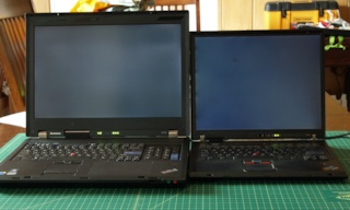

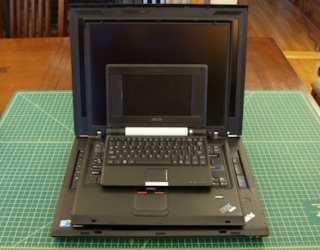

Size

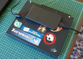

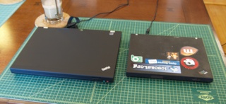

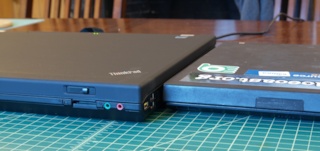

It's got to be said-- this thing is awkwardly large. The screen size may only be 17", but it's proportioned more like a 19-20" notebook. I bought two carry bags; one sold by Lenovo for '17" notebooks' and another for '17" and larger notebooks' and the W701 doesn't even come close to fitting in either.
My T42p, the biggest and baddest of all Thinkpads when I bought it, weighs 6.15 lbs, the W701 weighs 8.60 lbs. The 230W power brick is another 2.1 lbs. One review I'd read earlier starts by mentioning the power brick alone weighs more than six iPhones, two HDV camcorders, or Sony X505 notebook. It is in fact large (pictured above resting on the T42p).
The thing about it that actually feels weird is not that it is big, but that it's proportioned as if it was smaller. It really does seem like my T42p was simply loaded into Photoshop and scaled up by 20% except for the keyboard.
This leads to the first minor issue; the T42p is a good thickness for typing on. The extra 1/4" of thickness and 3/4" further back the keyboard is on the W701 makes typing on a standard 28" desk surface awkward. I have to sit higher, or hold my shoulders up to avoid typing with my wrists bent.

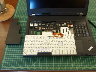

Keyboard

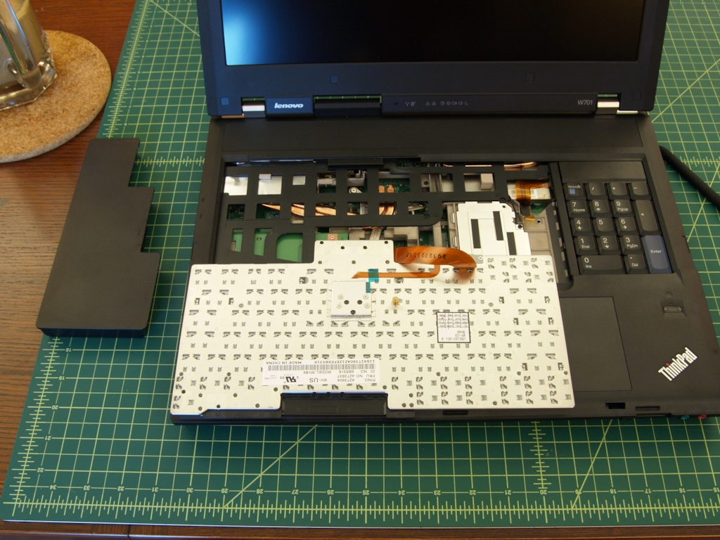

Much sadness! Despite the PSREF only listing the old, stiff-backed keyboards, my W701 arrived with the thin, springy 'full of holes' keyboard common to all the new models. Popping the keyboard off for inspection, it's clear there's a stiffener frame under it. Despite the stiffener, there's still more flex than on my T42p, The keyboard does't sit quite flush against the frame, so some locations are noisy (the left trackpad button has a loud 'clock' when pressed).
Oh well. That's what eBay is for. I have a verified old solid-backed replacment on the way. The bigger issue may just be that it needs to be more solidly mounted into place so that the case around it actually holds it solidly to the frame.

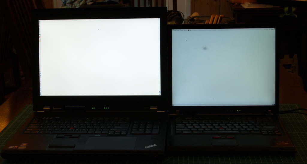

Oddly small for the notebook, if you can call a 17" screen small. It somehow harkens back to the early ThinkPads when the screens, as big as they were for the time, didn't fill the lid. It has a very 700C feel to it. If Lenovo had gone 4:3, they could have fit a full 19" panel in the existing lid.
The screen is bright and sharp, no dead pixels (you'd think that wouldn't be a worry anymore, but just last month at work I opened up a new batch of notebooks from a competing cheaper brand and several had bad pixels).
With both backlights cranked, 'black' on the W701 is slightly lighter than black on the T42p FlexView panel. The Flexview is nowhere as bright when white. The W701's black is slightly blue-green. The Flexview's black is slightly blue. The W701 screen is clearly much higher contrast.
Near-black levels do not appear to be spacially dithered at all. Just as good as the S-IPS FlexView here.
Smooth gradients are excellent for an 8-bit screen, even after calibration. You have to look very hard to see any banding at all. On gradients, the screen is noticably superior to the S-IPS FlexView.
The W701 has some minor high-frequency dither, less than on other panels I've considered to be excellent. The panel appears to be completely immune to pixel-walk/dither flicker as tested using the lagom.nl test patterns. Again, every bit as solid as the FlexView.
There is no power supply whine or backlight flicker at any brightness level. The backlight does not appear to be dimmed by pulsing, of if it is, it's a high enough frequency I can't detect it at all. My HDV vidcam also does not show any flicker when recording the screen.
That said, the TN screen has the standard TN viewing angle weaknessses. While good for a TN screen it cannot compare to the FlexView. The screen shifts toward red at the top/right and toward green at the bottom/left. Though far worse than S-IPS in this regard and easy to detect, the shift is not egregious.
Without calibration, the color temperature wanders noticably with luma like on most wide-gamut TN screens (greys are too blue, white is too orange and overdriven). Calibration effectively and completely eliminates the issue. The one thing I'd always loved about FlexView was that grey was dead accurate grey; not blue-gray, not yellow-gray, just gray, regardless of 10% or 90%. Color calibration 95% achieves that on the TN.
The last thing worth commenting on is the RGB LED backlight. I notice it. You can tell it's being edge-lit from the bottom as the component colors are not perfectly mixed there. About the bottom inch of the screen has a slight 'here's where a red LED is, here's where a green is, etc' pattern. I only notice it if the background is set to full white, and I possibly spotted it only because I work with RGB LED lighting, and I know how freaking hard it is to get a perfect diffuse white out of of discrete, widely spaced color LEDs. It is subtle enough I can't
actually get a picture of it.
The other odd aspect of the RGB backlight is that you can tell it's not a phosphor-- it is pumping three hard, pure colors. I wear glasses and the chromatic aberration is more jarring with the RGB light source. On a phosphor screen, you get a soft reddish tint or soft bluish tint on edges when not looking ahead through the center of the glasses. With an RGB backlight, you get perfect colored edges.

Quite a few people who touch type (I don't personally) have complained that the new lightweight keyboards Lenovo is using increase typing error rate because they're flexy, smooshy, inconsistently noisy, and not as good for speed typing. I object to the noisiness and the odd feel; there's a weird creakiness to the new keyboards.
Older 'solid backed' FRU replacements that are a stiffer build can be had for $30-$90 depending on where you get them and how lucky you are. I just ordered a T60 42T3109 keyboard from an eBay seller for $60. You can also call up IBM and have the send you one for about the same cost.

The keyboard is an easy fix-- though I agree it's a sin we have to fix it.
I figured out it's not the deck height as much as it is the keyboard being just a bit higher and bit farther back. My wrists hit the front lip of the machine in a way they wouldn't if the machine was thinner or the keyboard was farther forward. I'm actually getting used to it (at my main desk, I just pop my chair up an inch higher).
