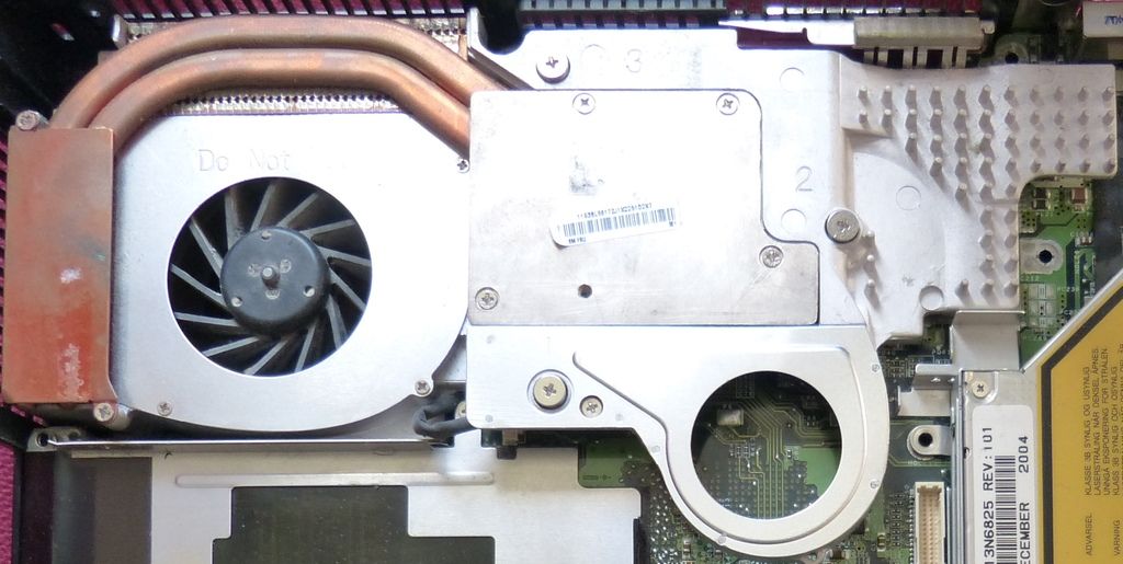

Re: G41 Project - Finished! 1 Pic
Apologies for the poor quality pic... I took that with my Sony Handycam. Can't find my MicroSD card converter, and me no have fanceh DSLR camruh.
But here it is! I've finally finished the G41... it took some time to find everything at the right price, but I managed to track everything down.
As I've stated in the first post of this topic-this thing has everything to make it the best possible G41 you can get aside from HD and RAM capacity. It's got the NVIDIA GeForce Go5200, the 3.46 GHz Pentium 4 Prescott, and an SXGA+ 15" screen. No, I haven't got an IPS... I don't think that was factory installed in the G41s at all... but I am still considering buying one from RBS, as that ad is apparently still on.
Here's some pics showing it after I got the motherboard in:
http://www.medessec.info/ebaysales/G41proj1.JPG
Too lazy to take screen off of G40... but I needed a good screen(without lines) to setup XP on the G41, so I just kinda... gutted out the G40 for it's LCD cable and had to position it next to the G41 chassis so the cable could reach.
http://www.medessec.info/ebaysales/G41proj2.JPG
My awesome fix to get rid of that pesky Fan Error code, fetched a T30 fan I had handy
http://www.medessec.info/ebaysales/G41proj3.JPG
http://www.medessec.info/ebaysales/G41proj4.JPG
Trying to show the pristine condition of the palmrest... I was able to find a mint-condition palmrest, with the stickers still on it looking fresh. Also a fresh genuine trackpoint on there, and keyboard.
It's pretty rewarding to see that working... a lot of people don't favor the G4x, but I think they look like an early ASUS ROG, or something like that, except they're not flashy... they're still designed for business, so they aren't modeled to look epic, but they still look epic. That's my personal opinion though...
But anyways, I've actually ran some older 3D games, the first Halo works like a charm, so does Command & Conquer, and Project 64. It can play Nintendo 64 games, i'm happy.
