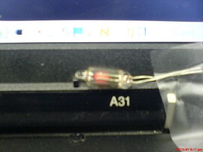

You might be able to determine if the inverter is working by using this little trick I posted:
http://forum.thinkpads.com/viewtopic.php?t=48910
The A31 I'm using here at work does not have to be disassembled. Merely hold the neon lamp up above the "A31" near the right hinge and against the little "nub" that sticks out to the left of the "A31", power up the system and see if the neon lamp flickers on for a second or two. If it does, and the LCD panel does not flicker or light up, then the inverter is putting out some voltage. The problem is finding a neon lamp! You might be able to pick one up from a Radio Shack-type electronics store.
By the way, could you please update your profile and enter your location (city/state)? It helps to see where people are and doing so can lead to faster and more accurate answers to your questions. Thanks!
edit: Here's a fuzzy picture taken with my cell phone which shows you where to place the neon bulb:
http://www.kawakami-ca.com/images/a31_neon_bulb.jpg
