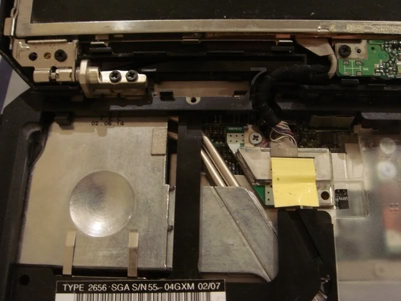

The fan on my R31 has started to make a distracting buzzing/whirring noise. I am using the maintenance manual to take a look at it and probably replace it.
I have got to the point where I need to remove the screen and the manual does not make any sense to me. How do I do it? I have attached two pictures to help. Seems that I need to detatch the wires in the black sleeve between the screen and computer but I cant figure out how!

Nice photos, so far looks like you’re making out ok, though I would appear that your TP is still plugged into the wall (Green LED lit!!) – You definitely want the AC adapter disconnected, and remove the Battery as well when you do this. Remember any electronic device is sensitive to ESD (electrostatic discharge) so take the necessary precautions to protect your equipment.
Start by removing the LCD connector screw (2nd photo - located to the right of the heat pipes, left of the LCD cable – silver screw). Check out page 117 of the HMM (page 123 of the PDF file). This silver screw holds the LCD screen connector to the mainboard, and should be removed (to free the LCD connector) before the hinge screws are removed. This way, minimal strain is placed on the connector.
I took the liberty of highlighting the areas on your photo as a visual aid. Good luck (See http://i262.photobucket.com/albums/ii12 ... emoval.jpg
RED – the LCD screw, DARK BLUE – the LCD connector (as connected to the mainboard), LIGHT BLUE – LCD cable to inverter / LED card, GREEN – left side LCD hinge screws (looks similar to those on right hand side).

Found one of my own pics that shows the same area (See http://i262.photobucket.com/albums/ii12 ... emoved.jpg). Because of my outstanding (poor) imaging skills, you can clearly how the LCD connector (which is a combination of a PCB, metal shield and wire) mounts to the mainboard (the socket is under that mess). Again, the screw as shown must be removed; the small black and grey wires are antenna leads.
