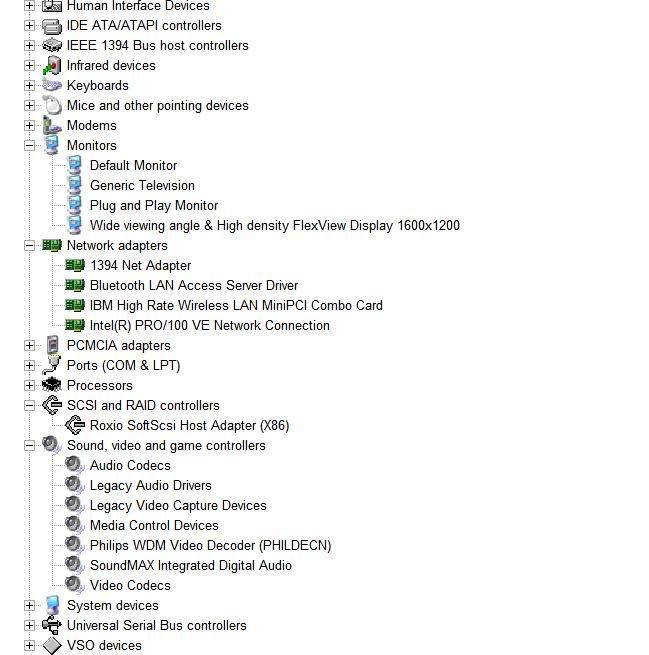

#9 Post by matermark » Sat Sep 27, 2008 2:47 pm
I can't answer about the ASPI driver but I think if you look closely at the properties box for the "Unknown Device" it says somewhere in there "on the ATI Fire GL 7800" or something similar, which to me indicated video related.
So, I opened up device manager on my older A31p and under Sound video & game it listed the Philips device.
On the newer A31p, it had an Unknown Device. I chose the Philips capture device from the list and the Unknown Device went away and Device Manager now looks similar to the pic shown. I believe it's the 6th line up from the bottom, the video decoder. Sorry, I didn't pay attention close enouf to remember if "Legacy Video Capture Devices" was present before choosing the Philips or not.
