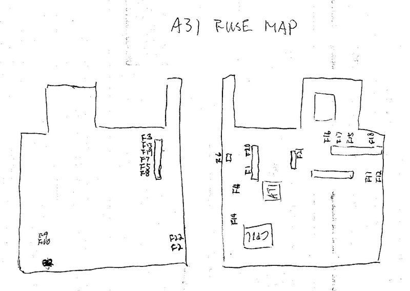

It could be a fuse. I don't have record of which one it is but here is a fuse map for A30/A31:

In that case you most likely have a blown fuse on the motherboard.
