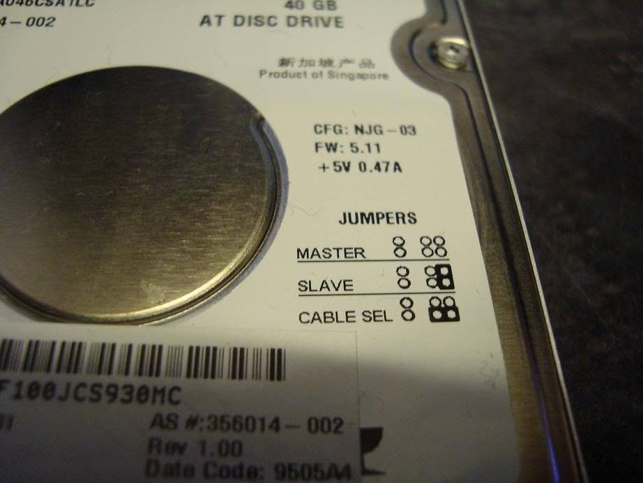

How to change the jumpers...
There should be a bit of plastic on the IDE connecter (on the drive) that looks like this...
http://uploaded.fresh.co.il/2008/04/24/65482408.jpg
Now on the CD/DVD drive there should be some information telling you where the jumper goes on the connector to change it's role, master, slave or cable select, I know this image is from an IDE HDD, but it looks like this...
http://i730.photobucket.com/albums/ww30 ... C02425.jpg
So then just move the jumper to suit, NOTE - 1) you must set it as "MASTER" if there is only one DVD drive 2) Use the jumper information that is on your DVD drive, not the picture I posted, that's just information to show you how the information looks.
Good luck!!
Good luck!!
