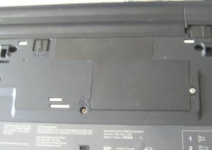

#4 Post by j00j4nt200 » Tue Aug 23, 2011 10:04 am
I glued some thing at bottom:
About touch pad... 1. is where connector is missing, but are 2 and 3 related to touch-pad?
