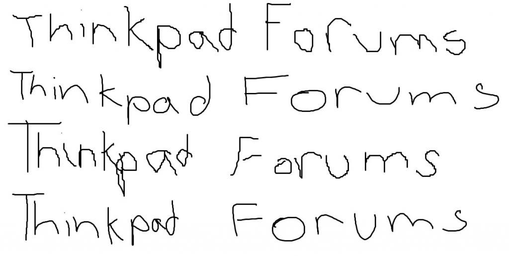

Re: A Review of Sorts: The Lenovo S100
What if you install multiple input device drivers? How would could it work like that then? No matter what settings I change in the Logitech or UltraNav options, the default Windows options always affect the cursor in the same exact way. I have been trying, and the effect of the default Windows options is always stacked on top of whatever I change elsewhere.pianowizard wrote:I believe you are wrong about this. After installing the mouse driver (which I always do), the driver takes over the control of Windows' Mouse Properties. Thus, when I adjust Mouse Properties, I am actually adjusting the mouse driver.
There should be a "sensitivity" option somewhere. Are you using generic Alps or Synaptic drivers? What about manufacturer specific ones?pianowizard wrote:If you look at my signature, you will realize that none of my current laptops are Thinkpads. I just checked my Panasonic CF-Y9 and Sony Pro13, and their touchpad drivers don't provide the option of adjusting pointer speed or precision.
Take a look here: http://i1179.photobucket.com/albums/x39 ... 443b4a.jpgpianowizard wrote:Thanks for patiently writing several long paragraphs to explain this problem, but I don't have this problem. Again, I think that's because Mouse Properties is actually controlled by the mouse driver.
I used my mouse for it, but it still shows what I am talking about. On the first and third lines, I had the Windows slider all the way to the right. You can see that the lines are jagged because the cursor hops around 4 pixels at a time. On the first and third lines, the slider was in the middle neutral setting. The lines are much smoother because the cursor moves around pixel by pixel. Open up MS Paint and try it for yourself. If it doesn't do the same for you as it does for me, color me surprised!

I tried it on my Panasonic CF-Y9's touchpad: http://i198.photobucket.com/albums/aa13 ... 0e9b21.jpgQing Dao wrote:Take a look here: http://i1179.photobucket.com/albums/x39 ... 443b4a.jpg
Medium + precision, medium without precision, and maximum + precision were all pretty good. Maximum without precision was horrible. So, I disagree that the "enhance precision" option makes things worse. Maximum + precision enables me to move fast without sacrificing precision.
