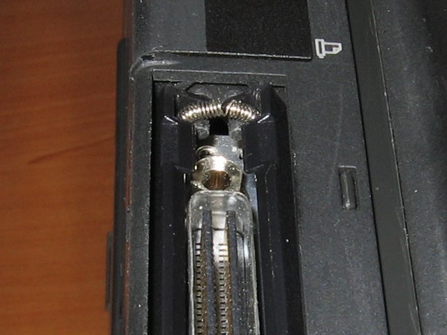

So, I found a docking station for my 600x. Works fine. However when I put it in, the little spring hinge that shuts the docking connector door when not in use poped out.
I managed to re-loop the spring and pop the hinges back on, but it doesn't seem right. Should the spring come out, almost over the white knob for the docking station connector, or should it be behind the pegs that hold the door in?

The spring loops over the two pins: http://www.kawakami-ca.com/images/ibm_6 ... spring.jpg
Re: Repair: 600x docking station spring door thingy
Thanks. Seems odd.. Anyway, managed to get it like that on my own.
