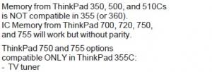

So, starting with the RAM, I see that it uses some sort of proprietary memory thing by IBM, and there are multiple check boxes on it (4-32MB), so I assume that the machine can do up to 32MB. I've found this on ebay
http://www.ebay.com/itm/Kingston-32MB-M ... 4ac623ac0d
but it doesn't list 355c as compatible. I swear it *looks* like it'll fit, but does anyone know if compatibility is going to work out?

Try searching on ebay with the following FRUs
http://www.thinkwiki.org/wiki/IC_DRAM_Card

youwonder wrote:thanks, I'll do that, but I don't see my model number listed on that page, so as a secondary thing, which should I be looking for, or will any of them work?
from page 11 of the relevant PSREF http://www.lenovo.com/psref/psrefs_withdrawn.html

balls so I'm limited to 20MB. If I stick a 32MB will it just recognize 20 of it or will it...be angry.
