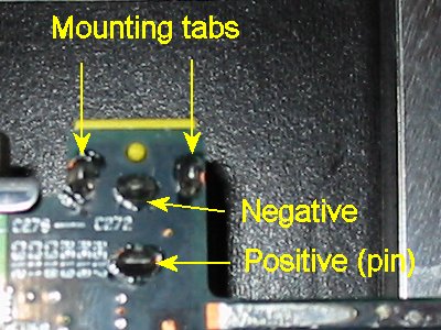

The DC jack is soldered onto the motherboard in four places. The two pins that are on the "sides" of the jack are for mounting only. They should not have any electrical connection to the pin inside the jack or the "tongue" which touches the outside of the plug. The other two pins should be inline with a plastic alignment post and are the negative (closest to the yellow post) and positive (furthest away from the jack's opening). After all that... here's a picture
http://www.kawakami-ca.com/images/ibm_6 ... bottom.jpg
Again, the best way to check to see if everything is wired up properly is to use an ohmmeter. About the only thing that can go wrong with the DC jack is that one of the connections inside is broken and then you won't get any power to the board. Set the meter on the lowest resistance range (typically 200 or 300) and put one end of the ohmmeter on the pin inside the DC jack and connect the other lead of the meter to the "positive" pin I've labeled in the picture. It should read 0 ohms. Do the same with the "negative" pin and the metal tongue inside the DC jack. It should also read 0 ohms. Connect the meter to the positive and negative pins and you should read "infinity". If you measure anything other than that, you have a problem with the motherboard.
The AC adapter is fine. I have 4 other 600's that it works great with... (and it is an original). The first one had a DC jack that was burned out when I bought it... but I just thought it was a bit dirty... but after closer inspection it had burned out and actually put a hole in the mobo. The second board was connected to a battery when it fried. I hooked up a heatsink to it to test and turned it on, I heard an odd noise before the laptop shut off. When I tried to turn it back on, I got nothing but a whiff of something burning. I swapped out the heatsink and CPU to test, and they are fine, as well as the LED panel. So I'm assuming the second is a complete fry, though I'm definitely open to other opinions. The first one I took to the shop to get a new DC jack soldered, but the guy told me that he couldn't do it (because of a hole).
So Right now I have only one board, and its presumed fried...
