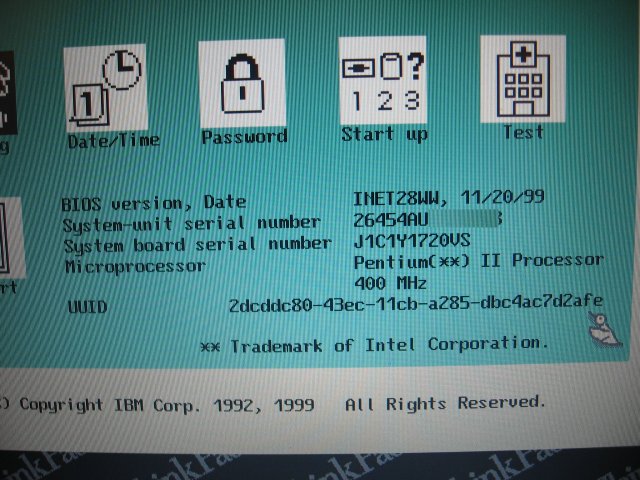

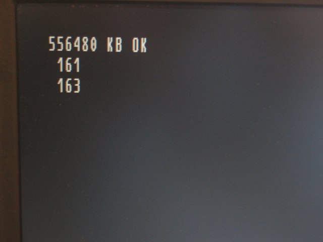

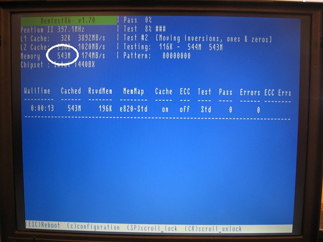

Here's some of the information that I promised:
http://www.kawakami-ca.com/images/2645-4AU_BIOS.jpg (INET28WW)
http://www.kawakami-ca.com/images/2645- ... isplay.jpg (BIOS indicates 544MB; ignore the 161/163 errors - dead CMOS battery)
http://www.kawakami-ca.com/images/2645- ... test86.jpg (memtest86+ indicates 544MB of memory installed)
As long as you have BIOS INET26WW or newer and are using "low density" PC100 or PC133 modules, then you should be fine.
