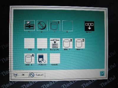

With the 600 series you have to press and hold the F1 key as you turn the power on. Keeping holding the F1 key down throughout the IBM Thinkpad "splash" screen. This will eventually yield the Easy-Setup (BIOS) menu. You can then use either the trackpoint (point and click) or arrow keys (press the Enter key) to select a BIOS menu option. I would start with the "Start up" menu. This menu controls which devices are checked for a boot disk. When entering the" Start up" menu you should have two options: "Power-on" and "Network". Select "Power-on". The top line of the screen has up to 4 "devices" that will be used for booting the system:
Image Click on the image for a larger (800x600; 81KB) photo.
This was captured from one of my 600X systems; the 600E should be the same. Each device is checked in order for a bootable OS. If none are found then you get the generic, line-drawn "insert floppy" display. It's meant to say that the system was not able to find any OS and that you should check your boot drive(s).
In my example, the floppy drive, then the CDROM and then hard disk #1 is checked. Only those devices are scanned at boot. If the HDD-1 icon is not in the top line, then the system will never check the internal hard drive. The Reset icon at the far right in the top line will clear all of the devices. The two lines below contains the list of devices that you can select from. Not all of them will be available at all times. For example, HDD-2 represents a hard drive that would be installed inside an Ultrabay HD adapter. Once you have cleared all of the devices from the boot order with the Reset icon, simply select each device, in the order you want, then click the OK button, the following EXIT button and then the Restart icon at the main menu.

Thanks Ray, I am familiar with a similar screen on my machine.....long ago ....before this disaster befel me!
I've tried booting and holding F1.......and all the other F Keys in succession, and each time the blessed machine just totally ignores me.
It does the mem count, loads the Thinkpad screen, and then ....nothing....60 seconds later there is a quick flash from the Hard Drive LED, and then the [censored] line drawing of the Floppy drive appears saying "Feed me, Feed me, and whilst you're at it hit F1".

Re: Thinkpad 600e suspect lost BIOS need help! *PIC*
Posted: Sun Feb 06, 2011 8:12 pm
by hexeta
Phil wrote:There is a reset button on the 600 series machines that will, I believe, reset the BIOS to its defaults. This should reset the Startup sequence to Floppy, CD, HDD1, if I'm not mistaken. And then you can try pressing and holding the F1 key during boot up again.
OOoohh!! Phil, I never noticed that, it isn't made clear in the manual that I have, just points to the visible power switch slider, and says something like "Power/re-set"...I had always assumed that it meant sliding it forward and holding (as in a hard shutdown) was what they classed as a "Re-Set".
Ooh! I hardly dare try it!! :shock:
Edit @ 01:15
Wooo Hooo!! :banana: After several attempts, it has begun to boot into Linux!
However, diskcheck has immediately taken over and has been going for a while now worryingly, it's been stuck at 90% for most of that time and there is seemingly no activity from the hard drive (LED).
I'll leave it for half an hour or so, can't take that long to check a 3.2GB drive!!
At least I now know that the BIOS are not corrupted, and that the mother board is OK!
Just hope there is nothing else to spoil things!
:banana:
Posted: Sun Feb 06, 2011 8:44 pm
by hexeta
Got impatient and cancelled the disk check and what a lovely sight... it began to load the OS.
Now all I have to do is try and remember how I managed to get sound, then how I managed to get it to endure a re-boot!
Oh happy day!!
Thanks to all of you who have rescued my little lappy, especially :bow: Phill for knowing about the re-set button!
What a nugget of 24 carat that has turned out to be!!
:arrow: Mr Happy! 8)
I'll have a play for a couple of days, and report back!
Grateful thanks once more :mrgreen:
Posted: Mon Feb 07, 2011 7:54 am
by hexeta
Hi Guys!
Posting from "Linux Land" with my trusty Thinkpad. :mrgreen:
I did manage to re-boot last night without incident, however, today was a different matter!
1st attempt got me to my login page and allowed me to type my username; this invoked the page for my password but it wouldn't allow me to type anything!
opened the note pad program (Leafpad) and that too didn't let me type!
It did however respond to Kb shortcuts to save, create new, etc......Odd!
I had to re-boot and then it wouldn't load; just the thinkpad screen, but no "beep".
After "poking in the hole" a few times, and removing my PCMCIA Wireless card, it booted OK and allowed me to enter text.
Then i reconnected the wireless card, and all seems to be fine at the moment!
I haven't yet tried to re-instigate the sound....that's a pleasure for later when I've got my caffeine levels up a bit!! :wink:
