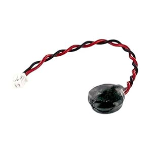

There's a main battery (obvious).
Then what the manual calls a "standby battery", and which plugs in next the the main battery connector.
Expensive little bugger, hard to find, 1.2V 30-40mA, such as http://batteryfinder.fedcoelectronics.c ... &_fid=2791
Looks like this: http://ecx.images-amazon.com/images/I/3 ... AA300_.jpg
And there is what the manual calls an "RTC battery", soldered onto the mobo.
This is of the 3V variety, such as CR2012/2016/2025/2032
An RTC battery is also known as CMOS battery.

@RealBlackStuff
The confusion is complete. At least here.
701c MM page 191 shows item 27 , standby battery: 04H8345.
In google various suppliers f.i Pacific Geek advertise this as CMOS battery.
Product Features
Round shrink-wrapped cell with two wires and two pin connector.
NiMH Volts: 1.2 , not a 3 volt coin type as you mention.
Please reconsider

Thanks for the picture, I ordered some batteries to redo my 701C today. Soldering should be simple (same batteries as pictured with the legs soldered on) but taking the machine apart will be the pain. The other battery with the plug isn't realy needed then is it?
Re: WTB: working ThinkPad 701C
Posted: Mon Feb 14, 2011 3:26 pm
by RealBlackStuff
I only had that 701c in temporarily for repair, and do not remember exact details.
Your mobo is different from the one I worked on, with different batteries, obviously.
I remember now, the backup battery looked something like this: http://ecx.images-amazon.com/images/I/3 ... AA300_.jpg
and connects next to the main-battery connector.
It's indeed the 1.2V version.
Apologies about the confusion. I'll correct the entries in earlier post.
