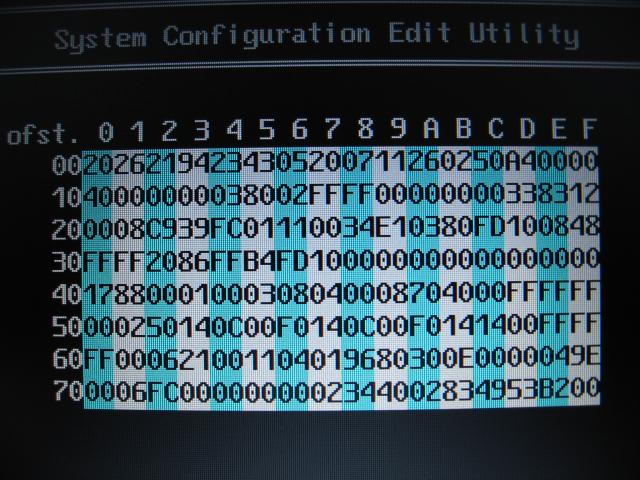

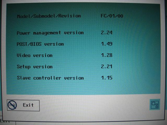

I've made some screenshots with all the infos from my TP600:
Test Procedure results:
Version Infos 1:
Version Infos 2:
----CTRL-D Config Menu:----

@Alex7: Thanks for the photos. It looks like you are running an older version of firmware than in my 300Mhz 600 system:
BIOS menu
Revision information
I have had a chance to do some experiments tonight and I've found 5 bytes that may need changing if you want to disable the IR port in the CTRL-D Config menu. However, before you attempt to edit these locations, I would suggest that you first initialize the CMOS using the icon inside the Config area. This will set all of the bytes to their default values and hopefully they will match what I found on my system:
Base128 CMOS
Note that the first couple of bytes in the first line, offset "00" to "03", appears to contain the date and time so the values will be different each time you execute the CTRL-D option. After I performed the Initialize option and took a picture of the CMOS memory, I ran the PS2.exe program and disabled the IR port. I took another picture of the CMOS memory values. Finally, I re-enabled the IR port and took another look at the memory. I then assembled all of the values in this table:
http://www.kawakami-ca.com/ibm_600/PS2_ ... R_port.htm
(also available as a .PDF file here: http://www.kawakami-ca.com/ibm_600/PS2_ ... R_port.pdf )
Each group of three lines (rows) represents the memory values after the Initialize, the "ps2.exe ir disable" command and the "ps2.exe ir enable" command. Since the Initialize operation is supposed to enable the IR port, I looked for bytes that changed to a different value on the "disable" command but returned to the Initialize value after enabling the IR port. I found three such locations at 22, 2F and 66. However, there were two other bytes that did not change the way I thought they should (70 and 79). Those changed when the IR port was disabled but still remained at their new values when the IR port was re-enabled.
If I were to bet on the simplest change that will disable the IR port, I'd go with byte 22. It changed from a C9 to a C8; one bit went from a "1" (enabled?) to a "0" (disabled?). The other bytes are probably the COM port and IRQ settings. This is just an (semi)educated guess
. Also note that this may only change the status of the IR port. I have not done any testing with disabling the serial and parallel ports.
BIOS menu
Revision informationI have had a chance to do some experiments tonight and I've found 5 bytes that may need changing if you want to disable the IR port in the CTRL-D Config menu. However, before you attempt to edit these locations, I would suggest that you first initialize the CMOS using the icon inside the Config area. This will set all of the bytes to their default values and hopefully they will match what I found on my system:
Base128 CMOSNote that the first couple of bytes in the first line, offset "00" to "03", appears to contain the date and time so the values will be different each time you execute the CTRL-D option. After I performed the Initialize option and took a picture of the CMOS memory, I ran the PS2.exe program and disabled the IR port. I took another picture of the CMOS memory values. Finally, I re-enabled the IR port and took another look at the memory. I then assembled all of the values in this table:

IT'S ALIVE!!! IT'S ALIVE AGAIN!!! Hoorayyy XD
Thank you all - especially rkawakami for all your hard work! You saved my Thinkpad
Your guess with address 22 was right. That's the only value i've changed and it worked perfect. I've pressed the 'Initialize' button of the config menu first and then i've changed the value of address 22 from C9 to C8. Then i pressed the F2 button and then F3 and after that i restarted my TP600. Then the 1201 error is gone. YEAH!
This is how my 'Base 128 CMOS' looks like:
I've marked all the values that are the same as your 'Base 128 CMOS with IR disabled' values with a red underline.
The only 2 values that matches your 'IR disabled' values are at Address 22 and 66. The value at 66 was already at 08 after initialization. So it was great luck for me that address 22 was the right point to awake my TP600 from the dead XD

Re: ThinkPad 600 error 1201 *PICS*
I am pleased to note that this works for the Thinkpad 560Z as well.
Although the default value is 0x41, changing the same bit (thereby changing the value to 0x40) clears the 1201 error
