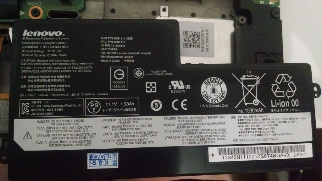

Thanks for the reply, I bought this one from Aliexpress:
http://www.aliexpress.com/item/11-1V-24 ... 68961.html
http://i51.photobucket.com/albums/f362/ ... yvhm2h.jpg
It claims to be FRU P/N 45N1111

That seems to be Genuine enough, although the 'AliExpress' had meRecife wrote:Thanks for the reply, I bought this one from Aliexpress:

The battery vendor is asking me to double check the battery is is correctly plugged in and to check the switch next to the hard reset button. I Believe the switch they are referring to simply detects if the back cover if off as there is a corresponding tab on the back cover that will depress said switch.
http://i51.photobucket.com/albums/f362/ ... ygwfp3.jpg
