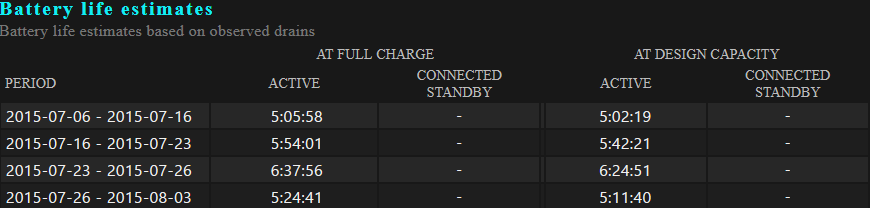

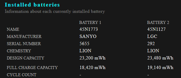

Is this normal with about 16 months of usage:
scroll..
scroll..
:eek:
Re: T450s battery capacity drop %20
Posted: Thu Dec 15, 2016 8:44 am
by brchan
If you use your battery heavily, then it is possible to have such a drop in 16 months.
