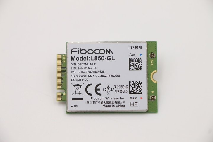

Hi guys,
I have find some T480 but without Fibcom WWAN Card and that is what I want to have. I know the difference between two cards that are offered but not sure what is the best option if I want to do this upgrade. I don't use Linux just to mention because the L850-GL need special driver. Question for owners, users or someone who made the upgrade what is the best option here, are the FRU number correct and where you have buy the WWAN Fibcom Card and the Antenna set?
• WWAN Antenna 4G Set - (70cm / 45cm)
FRU PN: 01YR494
• FIBECOM L830-EB - Cat. 6 (European version) - Up to 300Mbps DL / 50Mbps UL
FRU PN: (01AX761)
• FIBECOM L850-GL - Cat. 9 (Global version) - Up to 450Mbps DL / 100Mbps UL
FRU PN: (01AX792)
FRU PN: 01YR494
FRU PN: (01AX761)
FRU PN: (01AX792)

Hi guys,
nobody have done the upgrade with WWAN Antennas and Fibecom L830-EB/L850-GL WWAN Card on T480?

Re: T480 Purchase and Upgrades
I replaced it with a SN520 NVMe SSD.norrinraddhr wrote: ↑Wed Dec 03, 2025 10:45 amHi guys,
