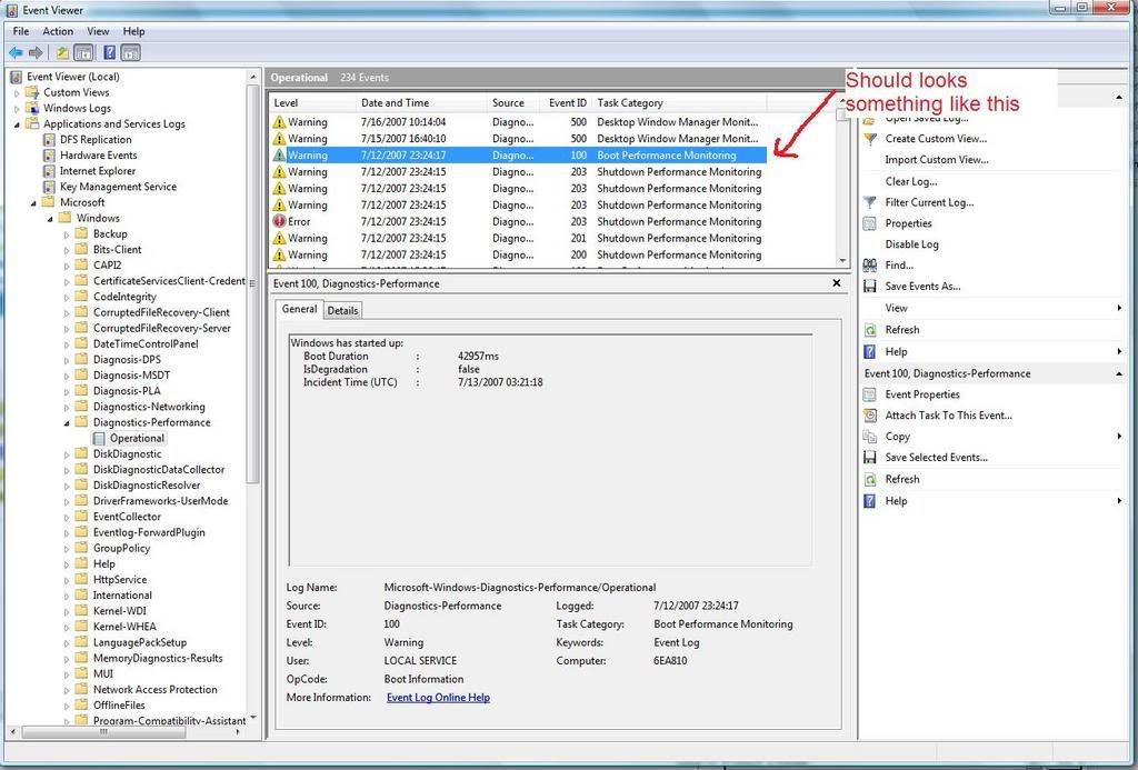

If anyone wants to know how fast it takes for Vista to boot up, you can use "Event Viewer" to see it.
On the left panel select...
Applications and Service Logs
Microsoft
Windows
Diagnostics-Performance
Operational
In the main part of Event Viewer, you'll see something like this.
http://i209.photobucket.com/albums/bb89 ... titled.jpg
As you can see, my system boots in a bout 40 seconds. I wish it was faster.

#10 Post by tomh009 » Wed Jul 18, 2007 8:35 pm
cpascu01 wrote: http://i209.photobucket.com/albums/bb89 ... titled.jpg
Is this from cold start to login successful? Desktop ready? Something else?

#11 Post by cpascu01 » Wed Jul 18, 2007 10:25 pm
It's from cold start to login screen. With my fingerprint reader login happens right as soon as the login screen appears.
