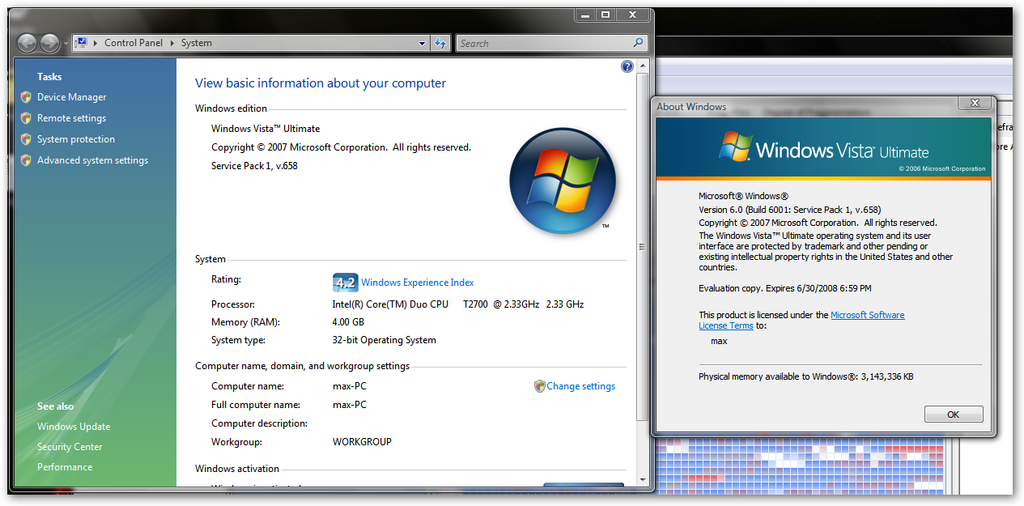

I just installed Vista SP1 RC and am now seeing 4GB where before I was seeing 3GB. Although 3GB is all that the OS can use. i just thought that it's interesting as with SP1 Beta and Vista with no SP only saw 3GB.

that's odd.   i've never seen vista report memory in "#.## GB" format -- it always reports as "#### MB".   vista x64 reports "4030 MB" and vista x86 reports "3070 MB" on my T61p.
i ran a test (linked here) showing the results of 4GB system memory under XP, 2003, vista x86, and vista x64.   if the official SP1 truly changes the results of vista x86 then i will re-test and update my findings.   if microsoft changed vista x86 to actually support memory hoisting (rather than simply reporting total memory installed) then i'm sure many users would be interested to know about it.

maximus_ wrote:I just installed Vista SP1 RC and am now seeing 4GB where before I was seeing 3GB. Although 3GB is all that the OS can use. i just thought that it's interesting as with SP1 Beta and Vista with no SP only saw 3GB.

Just to add some support to Maximus, I'll second that Vista SP1 does indeed report ram as GB. Now if someone would like to send me 4 GB of ram I'll see if my T60p also shows it as 4 GB. :D

yeah since the earliest betas it showed GB instead of MB which i hated. My T42 showed 2047MB instead of 2.0GB (i don't know where that 1MB went to) With the latest SP Beta it shows 2.0GB which is fine with me :) Other performance stuff too makes it run sweeter, even on another machine with 1GB and a 5400RPM drive instead.

It look like the other 1GB is unusable at with this chipset.

no, unfortunately that last 1GB still goes completely unused even though vista reports it as being installed.
