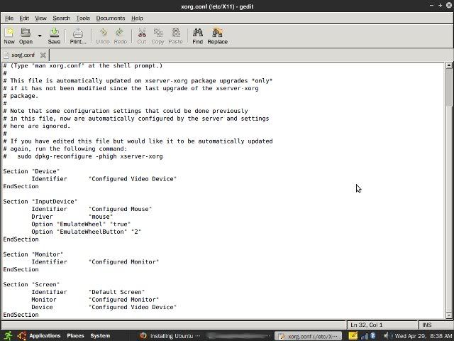

Gom Jabbar: There is no where for me to insert the script.
This is what I get when I run the xorg.conf editor. Notice there is no script for the mouse configuration. Where do I insert the script? If I flub- will it be easy to correct?
Untitled_no4: That page confused the hell out of me! I'm new at this script manipulation so how do I add a new file thru Terminal?

Okay. I got it working!
Thanks to some people who left links I was able to add lines (script bashing?) to the xorg.conf document.
All I did was copy and paste the lines from Section to the end section (Input Device) and insert it under the End Section of the "configured device" script.
After editing the document I saved it and restarted by pressing "Ctrl," "Alt," and "Backspace" to reset.
Now there isn't an icon for the trackpoint (like Windows) scrolling and you have to move the cursor to right of the screen to get it to work. BTW I also found (by accident) that if I pressed the blue middle button and the left-button above the touchpad I could rotate the screen. It's cool because it looks like a cube! I don't think Windows could do this without all the Hardware whoring they're famous for
