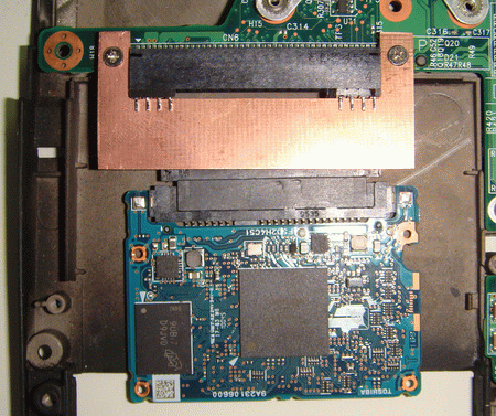

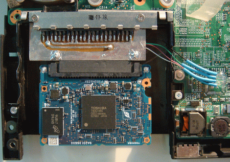

In case anyone is interested, this is the endresult of my T43 SATA conversion:
http://i597.photobucket.com/albums/tt56 ... ata005.jpg
When you remove the IDE connector, leave the metal studs. Then modify the long end of the connector (left on my first larger picture in amy first post in this thread) by drilling a matching hole for the stud and sawing off the rest.
You need some spacers to lift the connector off the mobo, but a SATA hard drive will then fit exactly in place of the old IDE drive.
For spacers, check if the wife/girlfriend/daughter has some glass or plastic beads of ca. 4-5 mm
Last edited by RealBlackStuff on Thu Apr 07, 2011 4:44 pm, edited 2 times in total.

#40 Post by RealBlackStuff » Thu Apr 07, 2011 4:51 pm
Thanks Harry,
it took me nearly 5 days to gather all my courage to blast that chip with a second-hand 1200W heatgun.
Total time spent on it: maybe 1 hour.
The white/black wires from chip to SATA-connector were cut from an 80-wire IDE cable.
The copperwire inside is thin enough to go through the mobo-holes near the former chip.

#46 Post by RealBlackStuff » Tue Apr 19, 2011 6:58 am
The info is all there in this thread.
SATA connections: http://mikejmoffitt.com/images/sata/pins_drive.jpg
You only need one Ground and one +5V connection (any, or 2 or all of the 3 within the group).
Ground I used coming from former IDE pin 40 off the mobo. (more grounds if you want: 2, 19, 22, 24, 26, 30, 40)
+5V I used coming from former IDE pin 42 off the mobo.
For standard IDE pin layout, see: http://en.wikipedia.org/wiki/ATA/ATAPI
(The IBM interface has 44 pins. WHY? Because they can...)
I removed several pins from 'my' SATA connector (since you don't need them all) for easier soldering.
And I picked my SATA connector only because it was the cheapest/nearest available from a US seller on eBay.
Turned out to be the perfect pick (for me).
The part apparently belongs to a HP DV9000 (such as this: http://cgi.ebay.com/ws/eBayISAPI.dll?Vi ... 0592819943 )
Why bother with an extra connector? It only increases the chances for something not working.
And I doubt if there is space for it, or that it even exists.

Then used a soldering iron to remove the 44 old pins. Theoretically you can cut them all of with a small wire cutter, but unsoldering them looks a lot neater.
You can probably use loose connector plugs, but my solution allows for swapping disks without having to dismantle the laptop.

That first picture is incorrect, looking back on it. Look at http://pinouts.ru/HD/serialATA_pinout.shtml for a more accurate picture.

And I used this, ("to be sure, to be sure" as we Irish say): http://en.wikipedia.org/wiki/Serial_ATA

RealBlackStuff wrote:I used a pair of pliers and just crushed the black plastic from the old IDE connector (held in place by the soldered contacts).
Yeah, that isn't it at all. I'll post a picture when I'm done but again:
Using the same sata connector mounted to the old ide posts, there are connectors (a plug if you will) that can plug in the back of it. This isn't loose, if anything it is more stable. I am using it for mine so I don't have to bend pins or worry about current jumping. I can still swap without taking the computer apart.

the thing i don't like about most of these SATA mods is that the drive pretty much becomes a permanent part of the machine, no easy removal as per the original design. and on the X41 the drive cage and the the way it clamps the IDE connector and system board to the case is a big part of the machine's rigidity i wasn't going to give up. because the actual board inside the kingston 2.5" SSD i used is tiny i had plenty of room to work out an adapter that would leave the IDE connector in place AND make the drive easily removable. this would be really easy to do on the T43 by using a 1.8" SSD.
for the adapter you just need to source an IDE connector from an old HDD and a SATA connector from some fried laptop, or get both new from some place like digikey. first pic is the adapter board being fitted before etching and the second is with everything soldered up. by removing the two screws the adapter can be unplugged from the original IDE connector.
thread on this mod: http://forum.thinkpads.com/viewtopic.php?f=3&t=90285

Yeah, you did an excellent job. The sata mod can be made very sturdy with a little work. I am considering getting another machine to do your mod to but this one is going to get the sata mod, I'm all set up for it now.

c4warrior wrote:Using the same sata connector mounted to the old ide posts, there are connectors (a plug if you will) that can plug in the back of it. This isn't loose, if anything it is more stable. I am using it for mine so I don't have to bend pins or worry about current jumping. I can still swap without taking the computer apart.
I have a HP DV6700 laptop here which uses this exact SATA connector. The connector is pushed into the hard disk SATA port, then you slide in and push down that HD with connector into the matching 'receptacle' in the HD bay. Using that very 'receptacle' would not be possible in a T43, there is no room for it.

Nothing fancy but it's humming along. Put my 780 proc in and my 500gb sata drive. The shims on the back of the interface are too fragile to use the connectors on the back so I just went with the soldering method. I also just cut the lines from the IDE and pulled the top interface off, used the bottom as my spacer.
Everything is great... though I seem to have a weird black rubber piece that belongs in the machine somewhere... for the life of me I have no recollection of what it is.

That black piece might be the one that goes in the top-left corner around the microphone.
The 'legs' would both point to the left when you mount it.
http://www.ifixit.com/Guide/Repair/Repa ... rd/2919/12

Hey, that's it. Thanks. I could not for the life of me find it on the pdf schematics nor could I recall taking it off. Must have just fallen off when I took out the board.
Also, do you find that adapter to be loose at all? This may not make much sense but... when I put in the screw from the bottom that goes in to the black piece that comes off of the metal cover for the slimbay, the black piece that goes over the two terminals we used to mount the adapter, it disconnects the drive every time. If I leave that screw out I can move it around with no problems. I thought that either I had left the adapter loose or that I had mounted it wrong so I've checked it and checked it again, nothing. It's nice and firmly mounted. Not that it exactly hurts to leave the screw out but it will bug me until I put it back in.

There's only one Ground coming from the mobo to the connector.
Your SATA connector has quite a few more, why not try and connect them all together?
That may help, let us know.

Some drives of mine didn't work unless I grounded all three of the power grounds that match up with the 5V pins.
