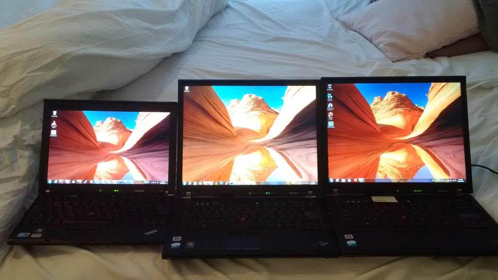

So I recently finished a Frankenpad build with the usual T61 motherboard in T60 15 inch body and a UXGA LED-backlit screen. It turned out reasonably well, although not as perfected as I would like. Here's a few pointers for people who may want to do the same.
The LCD
The part number of the Hydis UXGA LCD is HV150UX2-100.
The pinout order of the data interface is the same as other LCDs used in 15 inch T60s, but the connector is different. The existing 30-pin data connector on the LCD is a JAE FI-XB30SL-HF10, which must be replaced with a FI-XB30SRL-HF11 in order to mate with T60's LCD cable. (These two connectors are inversions of each other.) This connector may be salvaged from other LCD panels, or bought from the usual electronics distributors like Digikey or Mouser.
Originally I wanted to keep the LCD connector and instead modify the LCD cable, but JAE does not make a reversed connector for flex cables, so that's a no-go.
Since the connector is further down on the new panel, the LCD cable must be folded for the ThinkLight to reach the top of the screen.
The 14-pin backlight connector is a Hirose DF19L-14P-1H. The mating connector can be bought online as well, but they are designed for either flex cables or crimp contacts, and the tiny crimp contacts are useless without a crimper - they won't even fit into the plug housing when uncrimped. Of course, my plans for making a cable harness failed miserably, and I had to solder wires directly to the connector pins. Fortunately the LCD panel worked well afterwards.
The pinout of this connector is (from left to right):
1: VSS - ground
2-6: HVDD - power supply
7: Not connected
8: BL on - backlight enable
9: Vdim - PWM dimming control
10-14: VSS - ground
Solder wires from these pins to corresponding points on the inverter.
The CCFL driver chip on the inverter is a MPS MP1014. It shares the same pinout as MP1010B, whose datasheets are easier to find online. The required signals can be easily found by tracing from pins of this chip.
The chip has built-in safety features, and will shutdown if it detects an "open lamp" situation - i.e. when no CCFL is plugged in because we're using LED backlight. Therefore, it should not drain additional power after the mod. It would be cleaner to remove this chip and the transformer, but I didn't do so due to time constraints.
BTW, the two T60 inverters (one for XGA, one for SXGA+/UXGA/QXGA) use identical PCBs and almost identical parts, except the UXGA inverter has 2 fewer components. I think both are resistors, but am not certain.
Modem
Obviously, the MDC does not fit in a Frankenpad because the connector on the motherboard and screw bosses on the structure frame are in different places in T60/1.
The connector is an AMP 12-pin connector. I don't have exact part numbers, but the series has been out of production for so long it's impossible to buy new. The pins are 0.8mm pitch, relatively easy to work with if you have a fine-tipped soldering iron. Even though the connector has 12 pins, 2 are unconnected and 4 are shared ground, so only 7 connections are actually required.
I removed the connectors from both the motherboard and MDC and tried to solder wires directly between them, but I only have solid core wires that are thin enough, and they are too stiff for this purpose. They kept breaking off when I tried to bend them, and after repeated attempts destroyed the pads on the motherboard.
The LCD
1: VSS - ground
7: Not connected
10-14: VSS - ground
Modem

How is display quality and brightness compared to the original Flexview displays?

The panel is bright enough for my needs, almost to bright for work in dark rooms and for a while I switched back to a CCFL panel but then again back to the HV150UX2. The inverter only has seven steps of brightness, and I think the panel brightness could be turned down more.
The image quality of the ccfl-Hydis is perhaps a tiny bit better, or at least different with the LED giving a bit "plastic" white colour. Both are excellent in viewing angels, the LED perfectly uniform lit, very bright and nicely sharp. The colours are ok, nothing special and panels like 8740w dreamcolor have much better colour.
Re: Finished UXGA LED-lit Frankenpad Build, some thoughts
Like Lab, I also have noticed the less saturated colors when I put it next to my other laptops to make the brightness comparison that was requested a while back. But overall, my impression is more in line with lordvalumart's commnets - I find it to be almost as pleasing to work with as my Sony IPS UXGA desktop display (might be the same panel as lordvalumart's Dell 2007).
Here is a photo of my HV150UX2
http://i137.photobucket.com/albums/q223 ... c52484.jpg
From left to right: X201 with Hydis AFFS CCFL Display, T601 Frankie with HV150UX2-100, T60 with 'new old stock' LG-Phillips SXGA+
The photo exaturates the desaturation because the HV150 is so bright it burns out the colors in this cellphone-snapshot. Sorry about that. When viewed live, the saturation difference is smaller than it appears in the photo, small enough that I honestly hadn't noticed until comparing side-by-side.
I have calibrated mine with a colorimeter (a DTP-94), and would not have a problem using it for photoshop work if I needed to (but when I can, I prefer to use my Sony IPS desktop UXGA monitor). I also used the colorimeter to check the luminance of the two 4:3 displays over a range of brightness settings to get a numerical measure of the differences. Note that the Frankie with the T61 mainboard has 16 levels, where as the T60 system only has 8 (both use same inverter, the difference in number of levels is in the mainboard not the inverter).
T601 Frankenpad with AFFS LED UXGA HV150UX2-100
Monaco EZ-Color with DTP-94 Measures
Brightness Color Temp (K) Luminance (cd/m2)
15 6100 241
12 6060 200
8 5980 154
4 5960 108
0 5950 26
Resulting profile on brightness setting 12 = Black 0.28 / White 173.7 cd/m (target white point 6500K)
T60 15" 4:3 Flexview IPS SXGA+ LG Philips LP150E05(A2)(K1) (IBM P/N 13N7077, FRU 13N7078) - NEW OLD STOCK
7 (max) 5900 165
5 5900 84
3 5880 45
0 5870 16
Resulting profile on brightness setting 7 = Black 0.27 / White 128.0 cd/m (target white point 6500K)
So, numerically it is 46% brighter at max setting. For me, it definitely is too bright to work with in most lighting conditions, so I chose to profile mine at level 12 and use that level for any color sensitive work. In a completely dark room, I'll use it on level 2 to 8. That said, having that extra brightness available is still great for those times of the day when the sun peeks in the window etc.
Uncorrected color temperature on these are close, but I assume the CCFL lit one will wear into a warmer tone with time like my son's identical one has done. I prefer mine calibrated to 6500k, so the closer the un-corrected color to that, the better. You will notice the slightly warmer CCFL lit SXGA+ display has lost 22% of it's brightness in the calibration procedure, while the LED lit, cooler HX150UX2-100 only lost 13%.
15 6100 241
12 6060 200
8 5980 154
4 5960 108
0 5950 26
7 (max) 5900 165
5 5900 84
3 5880 45
0 5870 16
Hi Morten, is it possible for you to export and post your calibrated colour profile for the HV150UX2 display? I've struggled to get it right but with no real success. Especially the colours in the red part of the spectrum are not accurate.
