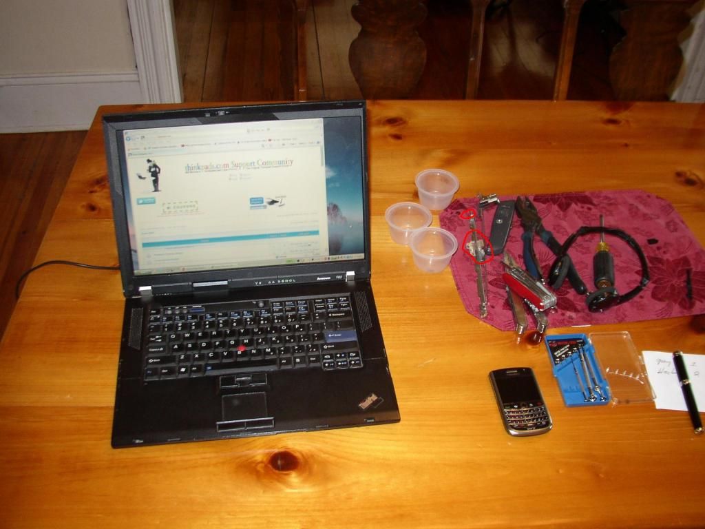

This is the second moderately difficult repair I've done. (The first was the fan -- twice replaced so far.) Here's a link to a pic of the completed project and the surgeon's tools. I circled the broken parts.

I took a ride over there yesterday evening and picked up my part for $25.00! Today, I did the surgery, and it was a monumental success. My ThinkPad has new, strong hinges and works properly. The display/lid no longer flops back to hit the table or forward to hit the keyboard.

Thanks RBS. You're right a nice philips head would have come in handy. I took the combo philips/straight blade screws out with the straight blade eyeglass drivers. And because the eyeglass screwdrivers didn't have very good grips, I sometimes grabbed them with the linesman pliers to break the tight screws!
That didn't work too well. I used the philips on the swiss army knife for the non-combo screws. I used the razor knife to get the little adhesive covers off the screws on the display bezel, but I also use a larger screwdriver to gently pry the bezel off the display and adhesive after the screws were out.
