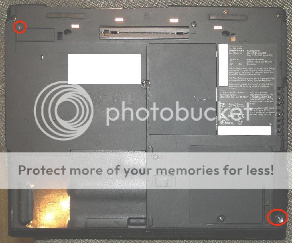

I have some screws missing...(See picture linked*)
- Unidentified upper left corner ? (Why this screw was opened ?)
- One HDD screw down right corner. (This opens HDD)

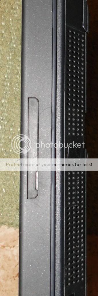

What is this ?(Broken ?)

About the second picture you posted... If you mean the small "chip" off that panel on the lid of your screen, that's actually a rubber cover, and the chip is to let you use a flat device to pry it off. So that's not a broken piece, no worries. Hopefully it's the same deal as on my A31p... it should cover an interface(bunch of contact nodes) that let you plug in a special camera to go on top of the Thinkpad. Sounds rare... for me, that's a challenge accepted.

Only that one screw(upper left red circle) near the DVD-player which one of the screws in the set is it ?
and why someone has opened it ?

The upper left missing screw is only rarely used. It's for keeping the CD-bay-latch locked.
In 99 out of 100 machines this screw is missing/not installed.
The rubber strip covers a USB-connector for a special T2x webcam.

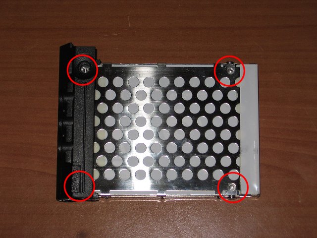

There is no threaded hole in the unofficial HDD metal case which previous owner had put in(with samsung 5400rpm HDD).
I bought the missing HDD screw and now I can't screw it in because threads are missing.
Where does the HDD screw attach to ?
- To the sheet metal HDD case ?
- To the hard disc itself ? (Do I need the original Hitachi drive to use the HDD screw)
Re: Buying a screw set ebay...
The screws simply pass through the caddy and thread into the HDD. Not necessary to have a Hitachi HDD, it's a standard screw hole, and as faar as I can tell, all 2.5" HDD have the same holes.

As Neil said, it's a standard screw hole that will be there as long as you are using a 2.5" IDE or ATA laptop hard drive. All manufacturers should have them. What may not be standard is the hard drive caddy (case). If it has a solid bottom and no cutouts for the holes, this may account for your "missing" threads. Here's a picture of the T23 hard drive caddy with the cover in place:
http://www.kawakami-ca.com/images/T23_hdd_caddy.jpg
In the photo, the upper left corner is where the HD screw would go. When installed into the laptop, the screw will go through the hole in the cover, through a hole in the frame and motherboard and thread into the hole on the bottom of the hard drive. The hard drive caddy should also have holes in the other three corners but for the T2x, nothing goes into them.
