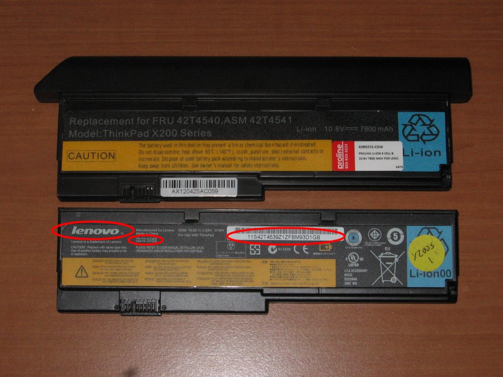

I would like to give away an X200s to my brother, but first I'd like to replace it's battery with a good one.
By perusing an old tabook, I figured that I'd probably want the biggest one, that is 43R9255, 9-cell one.
1. Where should I buy them online and how much do they normally cost?
2. How do I recognize an original battery from a third-party one? (original is more expensive and supposed to be better, right?)
3. Should I expect the replacement battery I buy online to be as good as new one was back in the day, or would they be old and dead? In which case, I would rather get a dead one and upgrade it at a local company: there's a local company fixes old batteries for laptops and other battery-operating equipment; they are in business for 10 years already, they are using new high-quality cells and appropriate equipment (spot welding, nickel tape) and give 1 year warranty on their work.
4. Do X200 and X200s use the same batteries? If you got either, please tell me its stated voltage and capacity.

2) Genuine batteries would have the factory "lenovo" logo on them, along with the proper FRU/ASM numbers and bar code label with part number and serial number. Those numbers can be read by Power Manager and should match. Bar code number is in the format: 11S<ASM P/N>Z<serial number>. An example can be seen here:
http://www.kawakami-ca.com/images/x200_ ... es_med.jpg
Top battery is a 9-cell "replacement" from Proline; the bottom one is a factory 6-cell (FRU 42T4648/ASM 42T4539). Note the missing "lenovo" logo on the Proline model. Also there's no bar code label with the proper format. "Knockoff" batteries typically try to copy the label colors of the factory model as close as possible so with a quick glance, they look the same. They usually do not have the multiple languages and certification marks like the original and most of the ones I've seen have "Replacement for ....." written on them.
